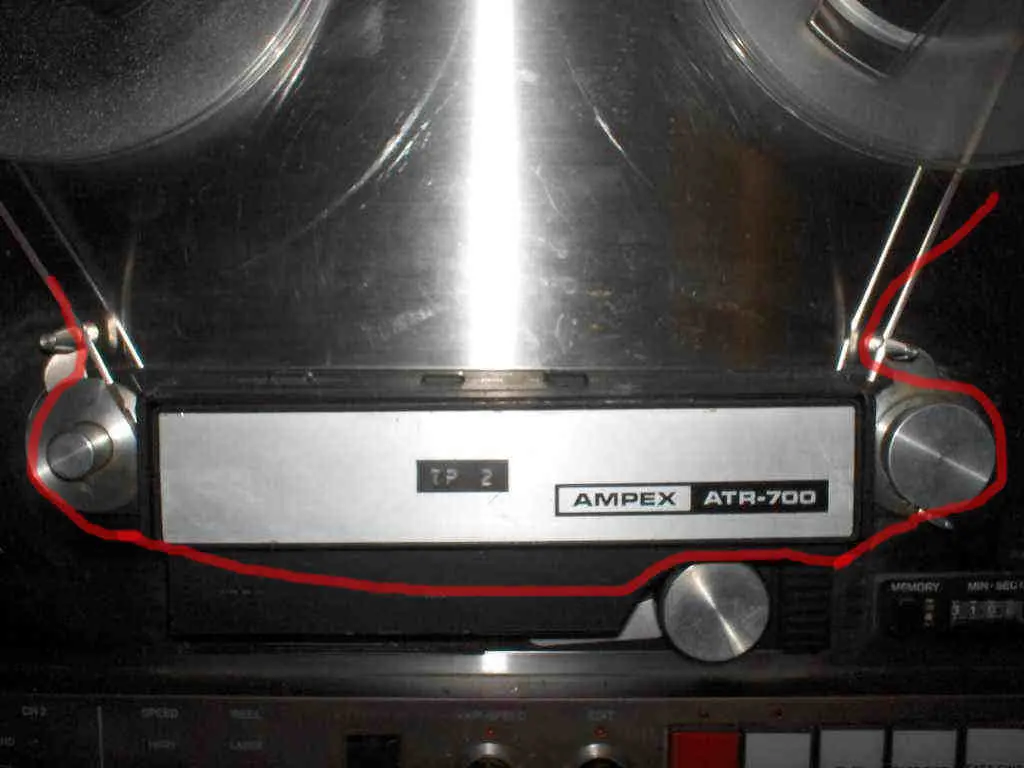

I figured as much (that I threaded it incorrectly)
Im gunna try and find an owner/service manuel right now. thanks
Here ya go. This is the proper tape path. Lift the head cover and make sure it goes between the rubber wheel (pinch roller) and the capstan shaft. What great art work. ;)

thank you thank you thank.
I messed with it and that seemed preety logical, than saw you post and confirmed it. the person I toook it to to look over it had threaded it an different way
So let us know how it works. :)
