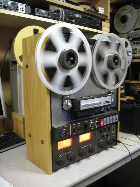

Hi Justin, How is that deck coming along? Your post made me dig my ATR700 out from under the bench. It has been sitting there waiting for desk space....
Some may recall that mine fell off a shelf that broke and bent up the reel that was on it. The deck suffered no lasting harm. Built like a tank. Except for one of the input level pots. Anyone out there with a parts deck want to get me a replacement pot?
I have both a working deck and a manual....
Turns out that I had a noisy output card. Some caps gone bad - quiet till it warmed up. But I did have a spare card that took care of that problem.
They look good in oak!
