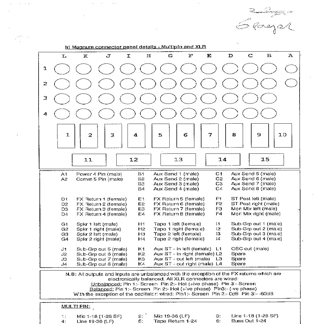

Ok. I have an Amek Tac Magnum and I am having a problem getting everything ready, My couple of problems are this, When I play back, volume cannot be changed with faders, and it seems the EQ's have no play in it either. also, I cannot hear anything in the earphones on playback. I am currently running this setup, and I have A diagram to go along (attached).
Monitors are in Spkr 1 and Spkr 2, my earphones are in Aux 5 and Aux 6, I am using my Multipin send to the alesis HD24 and its returning from the Buss in. My patchbay is ran from in>out >out>in.
Any help with this would be great, If you need more info just ask.

ok, Now i have the earphones working on sub channel 1, but now I am getting no signal into my alesis. .... Im as lost as you.
Hey guys... put the books down....lol.... I got it fixed.
