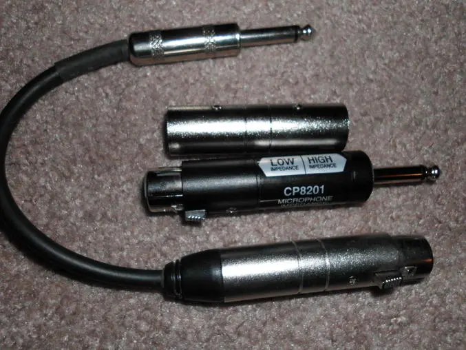

I found a cheap reamp hookup. Neither a direct line nor my passive direct box were doing the trick and the Radial X-amp was out of stock at GC. So i used a 1/4 to XLR cable out of my interface to a Male to Male adapter to a CP8201 mic impedance matching transformer into a Marshal. Worked great and cost $180 less than the X-Amp.
I'm thrifty like Jesus! :D
