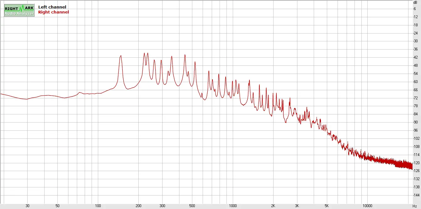

There is a big spike on a RTA at about 150Hz. Are you on 50 or 60Hz mains?
