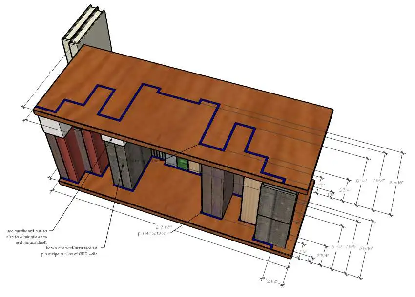

wonder what happens if you stack the books in approximately the same ratios as a QRD diffuser? you could calculate the QRD 13 or 19 diffuser and arrange books by relative width and depth... then if anyone asks how you sort your library you can tell them "by quadratic residue sequence" :-)
You'll need a DEEP bookcase to offset books with these type well depths. AND the book thickness's will have a bearing, maybe using two or three to get the right well widths. :) I hope you know I was only trying to illustrate the concept, not to say books could not do the job if implimented correctly. But in reality, random arrangements do little for true diffusion. And even if you DO achieve a similance of a diffuse sound field, understand 2 things. Phase grating devices are ALSO 1/4 wavelength SILENCERS :eek: Not to mention your room dimensions and absorption in the room will determine the decay rates of different frequencies, which has a bearing on the so called "diffuse" sound field. Even experts admit that measuring diffusion, especially in a small room, is a very difficult if not impossible task. :confused: Not only that, but the room dimensions govern the lowest frequency you could possibly diffuse, if even possible. At least, thats my understanding.
I noticed Ethan Winer now has a new diffuser/absorber unit on his realtraps.com web site...
Ethan - when looking at "typical" plans for a QRD diffuser, the well walls extend all the way to the front. in the pictures on your site, it doesn't look like the diffusers have well walls. how does your design compare to the typical diffuser design?
i was thinking if you did the QRD calculations and then used pin stripe tape to layout the design on each bookshelf (pin stripe tape is thin and would be discrete...) then stacked/arranged the books to fit...
agreed the depth and width of each "well" relates to the lower and upper frequencies affected. however if you stick with a QRD with 7 wells per period, then your effective depth is twice that of using 11,13, or 19.

thanks! from the photos it looked like you made a new type of diffuser and I was curious if somehow building them without wells did something more interesting or better... on second visit if i look at the top i see them... it was that straight on shot that made it look that way...
