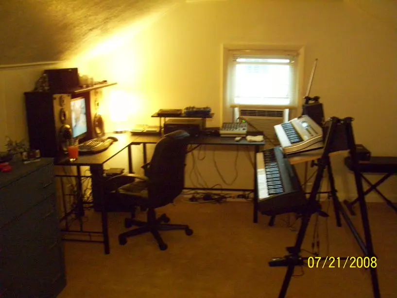

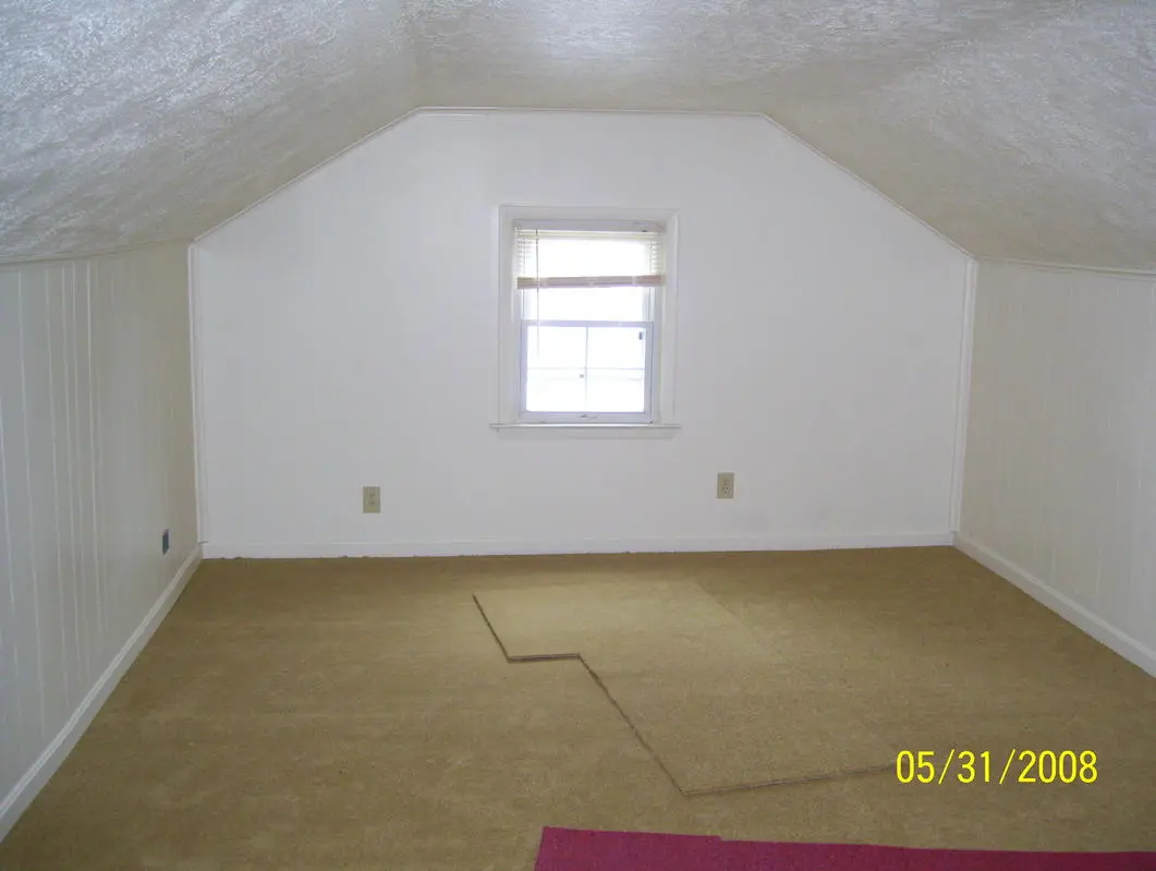

Hey everyone. noobie here. I've had several very cheap "recording studios" over the past 10 years or so never really digging into the technical aspects of home studio recording (and how it's showed!). well, I'm now moved into a new house with a really cool recording space. (see pics). well i have a small space left to the right of this to put some acoustic paneling on two walls and a ceiling. the problem is the cost!
Well, this afternoon I went by a sporting goods store closing and they had gun case foam (egg shell crate style) on clearance for around $30 for 72x 30x2 sheets. it is almost exactly like the mattress foam you can get for extra padding. i was wondering if it was worth picking up to use to line my walls for acoustics when recording vocals and acoustic guitars or is it made completely different than real acoustic paneling?
second questions is about mic placement. in the picture the right side is what I'm working with. as you see the ceiling curves up. i have from the window over to work with. should the mic go against the walls, maybe in the corner, with the padding behind it or away from the wall into the open space with my back against the paneling and a small bit of paneling behind the mic?
Thanks in advance!
Tony

Far too lightweight, probably decent and sucking up around 5-8kHz (I have yet to be in a room with issues at 5-8kHz).
You're going to have substantial low end issues (as every single standard construction room does). Always, always, ALWAYS start with the low end. Foam is for "touch ups" - Not for treatment. Especially ultra-light packing foam (which is worthless for most everything - except packing).
Mic placement? Always away from the corner (preferably, out in the room), always with a good amount of broadband trapping (again, no foam) in that corner.
