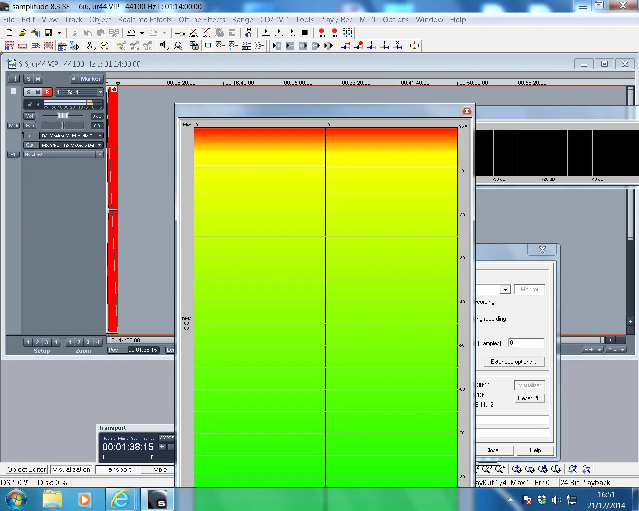

Dave, I'm actually not sure how accurate that figure is. I just played the hiss back in my daw and then in cubase I measured it through the decibel reader in the fader. However you can hear the difference in the hiss between both units
But how did you allow for the gain difference and did you put a "silent" load on the mic inputs?
13dB diff is a hell of a lot. I have never found any two pres that far apart when you correct for gain.
To be honest, I guess I measured it wrong. I did it by the noise coming from my guitar in Amplitube during a silent part. I can post a clip if you are interested.

I don't believe they were both pushed to the max, one may be pushed more than the other. I didn't test them scientifically.
