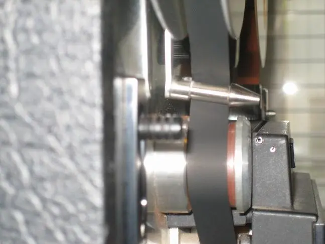

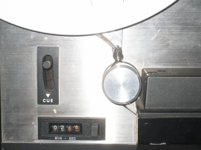

Here are a couple of pics. It looks like the tension arm is bent now that I look at it. The picture with the flash is hard to see, but you can see the side of the tape that you record on when you look directly at the machine. What do you think?

Carefully bend it back!!

Is there going to be any way to find a replacement for it? I'm beginning to freak out a little bit. or i'll just bend it back like you said...
No need to freak out just do as Dave (ARP) said: Carefully bend it back. ;)

Thanks guys... i guess I'll just try and bend it back. So is that the reason my tracks are out of sync now by chance? And I have no idea how it got bent. This is weird. :confused:

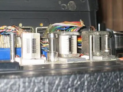

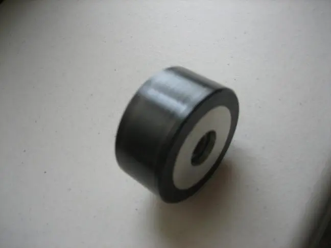

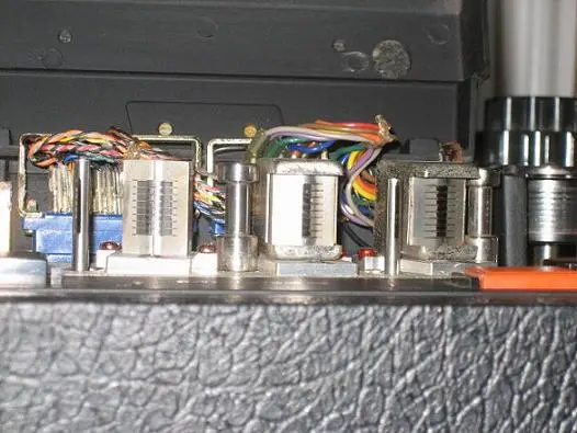

Here are some pics. I had a hard time getting a good picture of the heads, but this is the best I could do.

The heads/lifters look worn & the pinch roller looks slick!!! :eek: ;)
