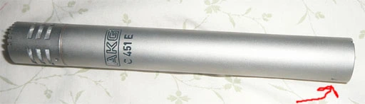

ok here are some pics:
another:
and here's the mic:
(actually, this is the mic that seems to be working - but it looks just like the other one)

that's a not a screw - it's a scuff mark. I agree that the guts should slide out -- more pics in a second.
OK - here's the top, without the CK1 capsule screwed on:
and to help establish (to myself included) that I'm not schmokin' rock, here's the scuffless and screwless body of the mic with the problem:
Any chance that the tab sticking outwards from the "locking ring", as you put it, might actually unscrew the guts if you spin it often enough counterclockwise?
