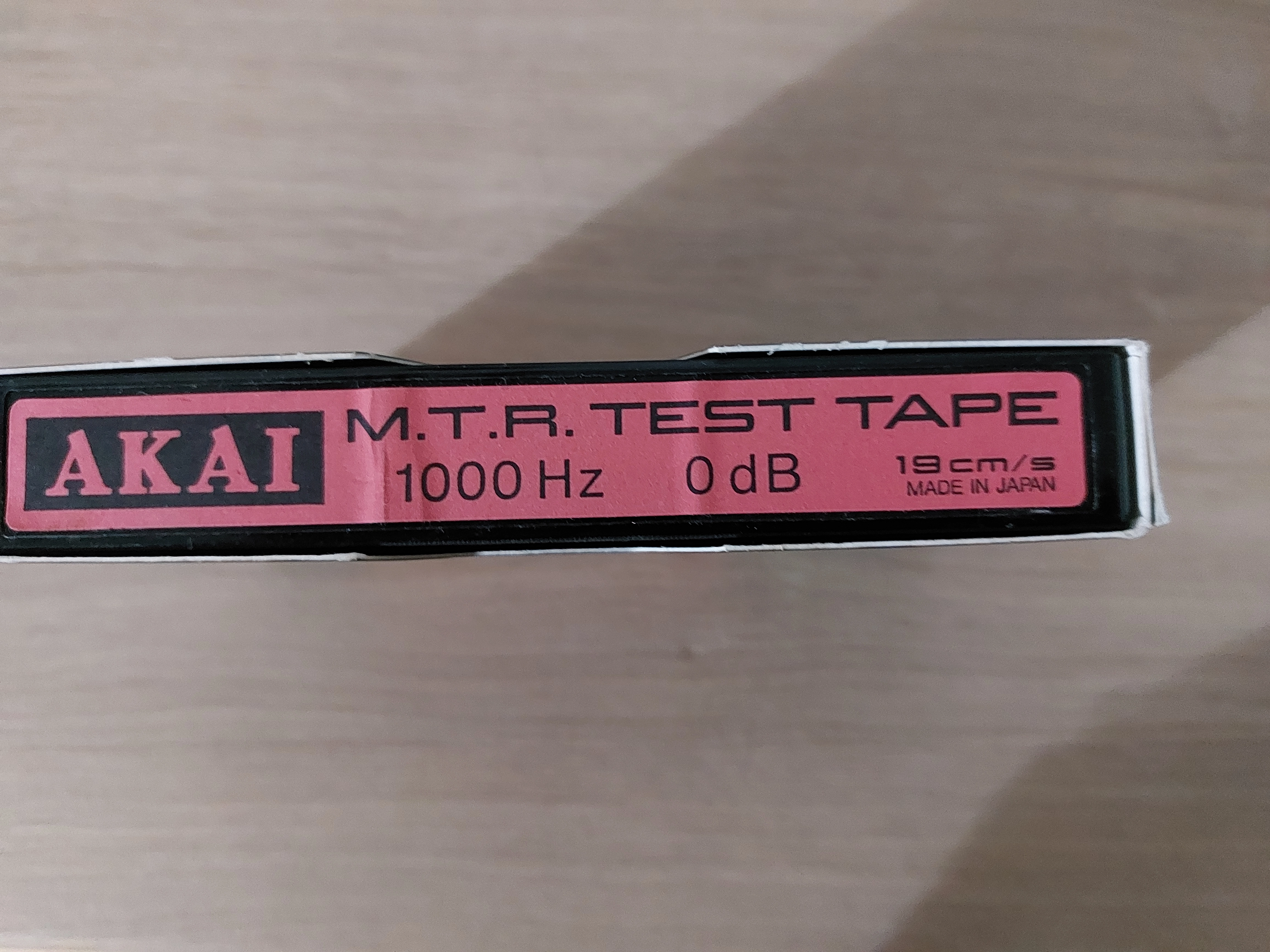

Tape head calibration might be needed depending on how much the recorder has been used.

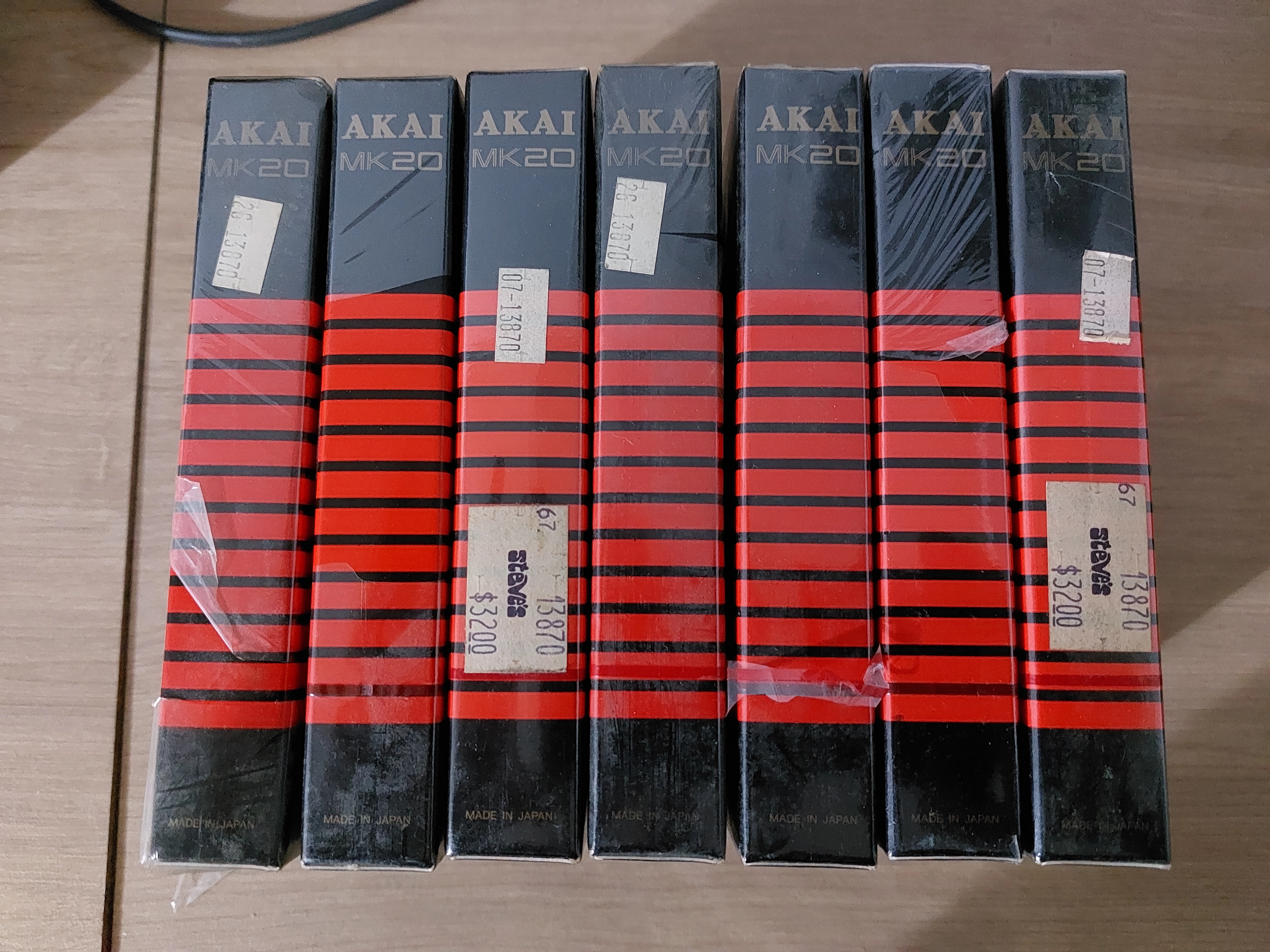

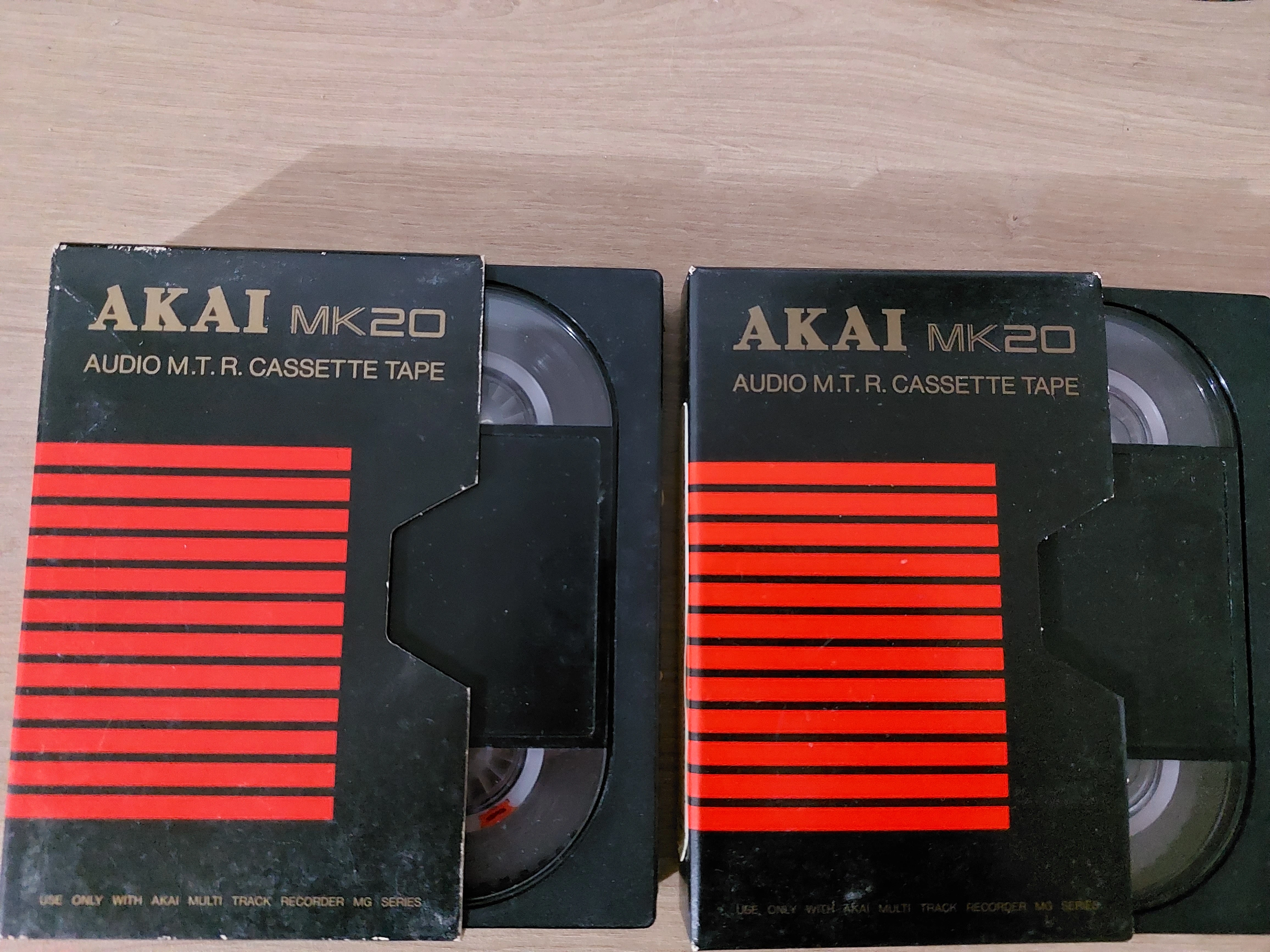

If needed I do have an original MTR test tape -1000 Hz - 0db along with a number of new and used original tapes for the recorder.
