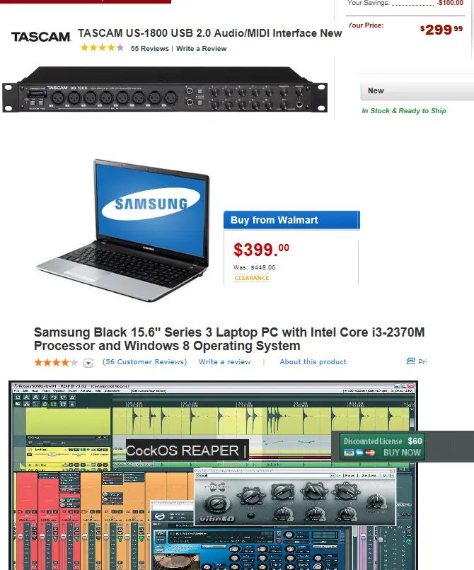

Here you go... then start collecting Free Vst's for eq's comps', limiters, etc..etc..
Heres your portability (laptop) and 8in/8 preamps...

Thats great.
So you'll don't think they'll be much difference between something thats $500 and $1000?
(Surprised that Tascam is getting more love than the RME or FOcusrite?)
I want 8 inputs so that I can do drums etc... 8 outputs would be a great option so I have the option to bounce it out to tape if I want to.
Price point mostly and it gets the job done.
I just dont understand what I would do it my interface had say 2 preamp channels on it, would I effectively have 2 preamps or just miss out the preamp bit of kit on 1 & 2??
Not sure I completely understand your question, but... if you want 8 mics, you gotta have 8 preamps. If your interface has 8 inputs but only two with preamps, you'll need 6 external preamps. That is the nice feature of the tascam unit, 8 mic preamps and A/D conversion. Perfect for recording drums.

I used to use inputs 9/10 for disposable tracks (scratch vocals/guitar) or HH and Ride mics. They are in effect, preamped inputs. XLR to 1/4" adapter and you have 10 useable mic inputs with the 1800. :)
