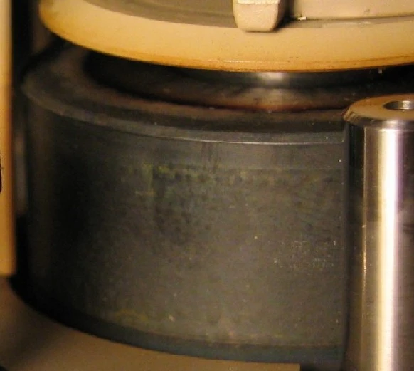

Here is a closeup of a good capstan shaft (albeit in need of cleaning :o), and a bad pinch roller (IMHO). Though the pinch roller doesn't look too bad aside from needing cleaning, you can see the little bumps I'm talking about. That is a sign that it is hardening and sort of delaminating. It can cause playback problems.

Are these both of the pinch roller? The first is too blurry to tell, though I see the counter-roller in the background of the fourth picture so I'm assuming it is the pinch roller blurry in the foreground. Anyway, this pinch roller looks dried out, glazed and hardened. I'd replace it. You can likely get one direct from Tascam. Don't get it off of eBay. It'll be cheaper and factory-direct from Tascam, and while you're at it I'd order a new capstan drive belt too. If your pinch roller is in that condition I'm guessing the capstan belt could use replacing as well.

On your original issue though of the wow and flutter, a new capstan belt and pinch roller may take care of that issue to a great extent, and if you plan on using this machine it appears to me that it is time to do that anyway, so even if there are other issues replacing those two parts won't hurt.
