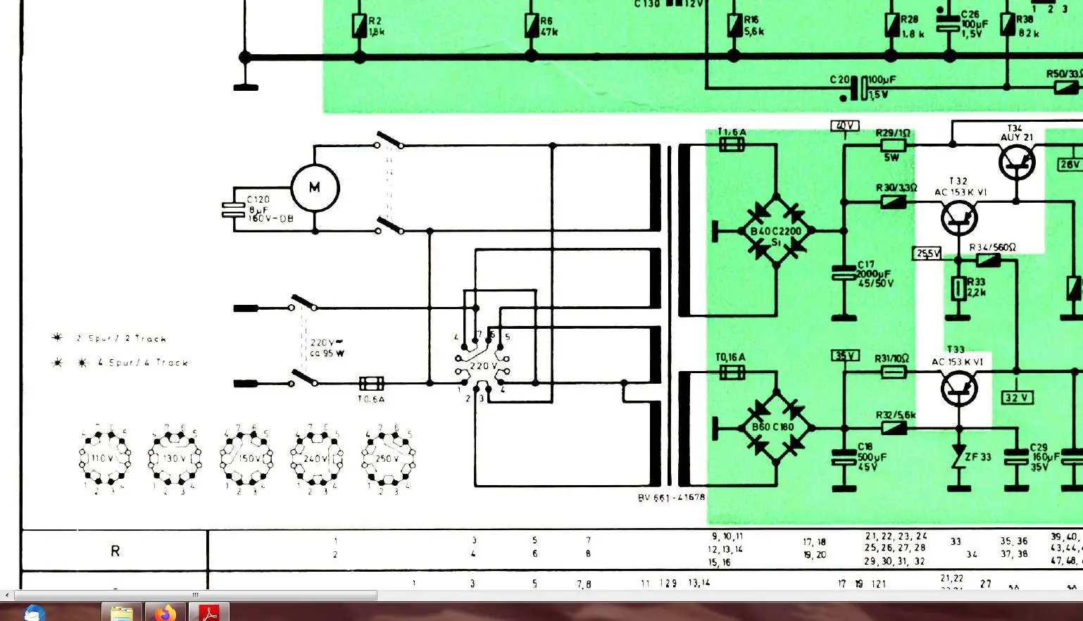

I have an old reel to reel that I want to use to bounce stereo mixes for tape compression (and dirt). It's an old 7.5 ips Uher deck with two-prong cable. Should I, and is there any value to, replacing this cable with a three-prong grounded cable?
Mine looks like this, but is different:
Mine has a two-prong US tail cable instead of the Euro style.
As a rule of thumb, if a product needs a ground (which of course is for safety, not noise purposes) it will have one. In Europe we have two classes of equipment. One needs a ground - an absolute essential designed in feature. Operating it without the ground is dangerous. Remember we have 220/240V power here.On the other hand there is double insulated equipment that is electrically safe without a ground. Connecting the chassis of these to ground removes the built in separation the double insulation provides so again, is not recommended. If it has a two conductor mains cable, leave it alone. These Uhers were not the nicest recorders - some of their range were superb, others were quite domestic in quality - but as you are dirtying the audio up, I guess that's what you are after?
There is a good case for replacing the ungrounded power cables on older tube guitar (etc.) amps.
I'll go with it does not need a ground. The power transformer isolates the AC mains from the chassis ground of the deck so there is nothing hot from the mains that would normally get through to the chassis and create a shock hazard. Not sure if you may have issues with hum depending on if the gear you're connecting the deck to is or isn't grounded well. I had some problems with an older Tascam USB interface that had a poor ground through a computer via the USB connection and had hum/noise issues.
