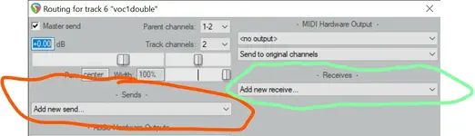

Have you clicked on the matrix menu?
Track inns and outs..click on routing.
and
Cntrl + Alt + G is the grouping matrix..get there then click in the upper box to get to routing..I cannnot remmeber the hotkey..
With the Reinsert as the track 7 , this is how it looks. Control all routing in the matrix. Play with it.

scroll down..
check the appropriate boxes.
