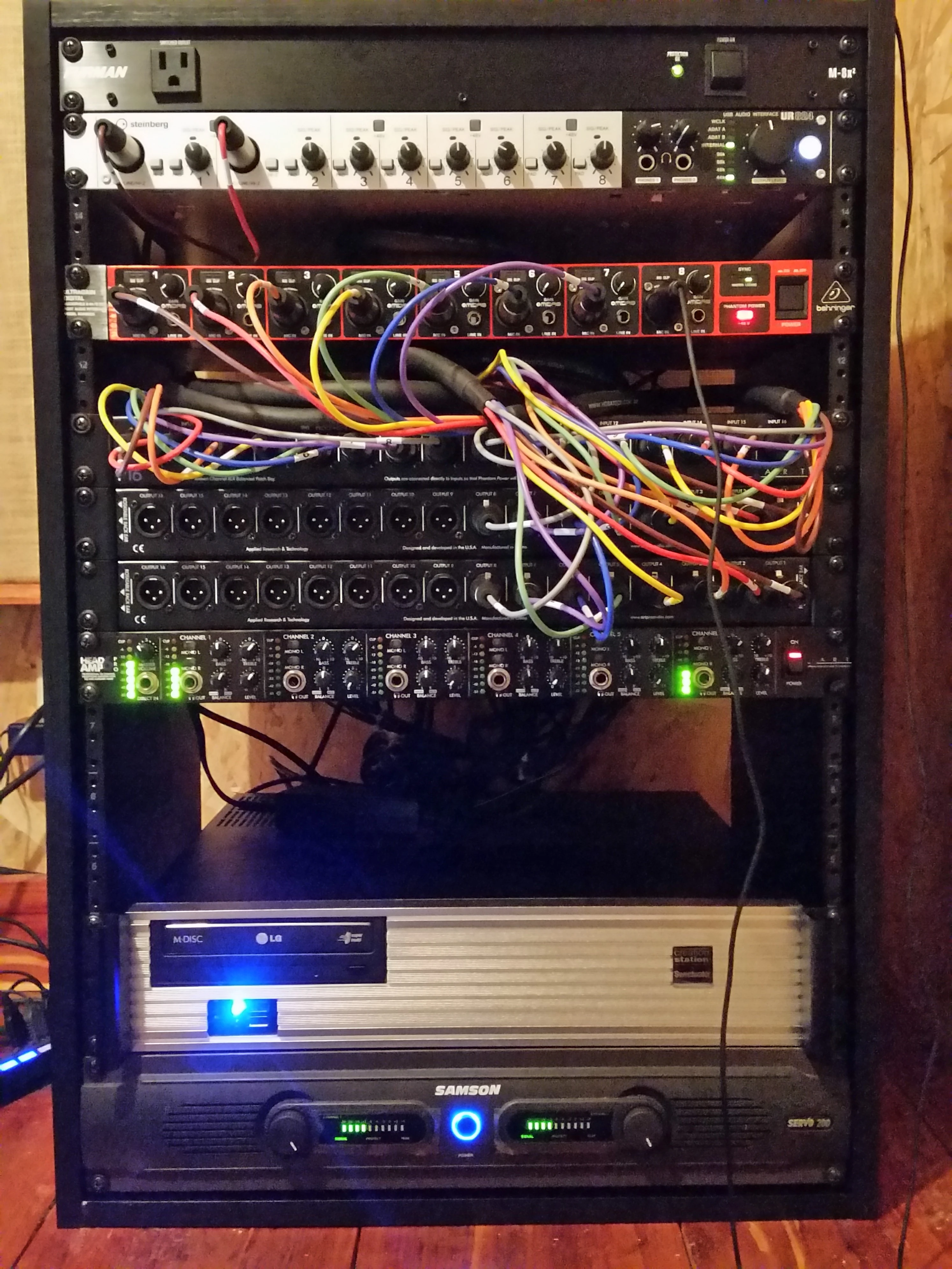

I added a ADA8200 as a slave to the UR824, it was really simple to set up. My rack was full so this is the new setup.:D

nice, the 8qty simple ada8200, great reviews , great converters...maybe Behringers best piece.
for interfaces with jacks in the back the ADA8200 offers the ease of front jacks looks good too for a desktop.
Are you taking the output from SPDIF or XLR x8 ?
Is each XLR output a direct line or is it post preamp & converter?
is it quiet?
is it quiet?
I have the ADAT in/out from the 824 connected to the 8200 out/in with light cables, I set the 8200 switch to slave, not sure about the post preamp question. all I have done so far is record a MP3 signal, I used one channel from the 824 and one channel from the 8200, I could not tell a difference. I have the channels from both interfaces terminated to the XLR patch bay, also have my 3 snakes terminated to patch bays, so I do all my patching with the patch snakes at the rack. Thanks!:D
