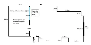

This jpeg show size of our flat for recordng. The height is same for all walls and it is 2.60 m.
We will make some different kind of music like rock and cultural music. Our music is loud and we need to put some acustic treatment. I want to place some diffusers and absorbers on the walls but do not know where to put exactly.
There is three aktive loud speakers (800 wat) in the room and tascam dp-32.
So in this room, where should I place the absorbers, diffusers and loudspeakers in the room?
Sorry if I am mistaken in some parts.
In a room that size, you'd probably be best served ripping it down to the studs, filling them with rigid fiberglass or Roxul Safe n Sound and then stapling cloth over it. Especially if you're talking "loud" --
Diffusion is going to be the least of your worries. Getting the low end under control is going to be (as it almost always is) the primary issue.
THAT SAID: If you fill the studs and maybe stack the corners, you could probably put up a few poly-cylindric diffusers to liven up the space a bit...
If yanking down the wallcover is not an option, you're going to need bass traps/superchunks in all the corners, including those little 80cm/60cm ones, not just the main corners. Are you going to be mixing in that room, too? If so, you'll probably want to move the desk/monitors as close to the door of the left-side room as you can to get symmetry in the listening room.
What is the flooring? How high is the ceiling?
Okay I can do superchunk bass traps in all corner, not a problem I have stuff and time.
It is good point that you remind me to come to door side for symmetry. We did not open the compact class place, so I will bring it t middle as possible.
