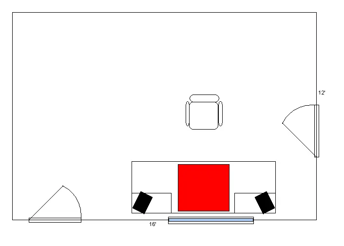

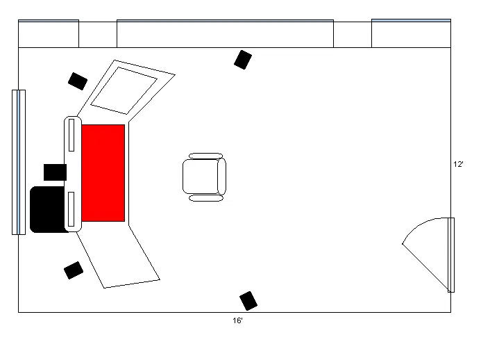

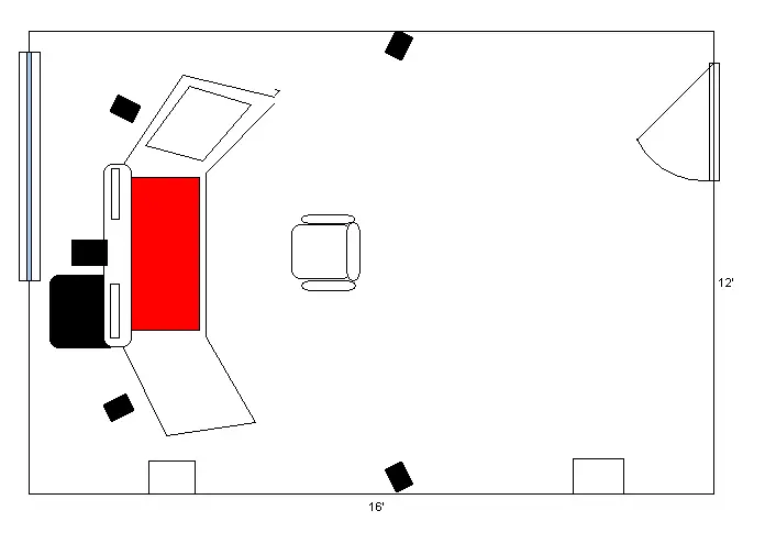

Infact here are some plans of the room, and if you can recommend something, I'll print it off and take it in.

pandamonk said:
do you have distribution to the UK? We will probably order between 6 and 10 far version diffusers, a few mondo traps, or possibly 3 mondo room kits.
We sell direct all over the world. If we sold through dealers the cost would be far higher because they'd expect to even double or triple the prices, and you'd still have to pay for shipping. Typical shipping costs are listed on the Prices page of our site, and I'll be glad to get an exact quote when they're ready.
> if you can recommend something, I'll print it off and take it in. <
All of the advice on the Placing RealTraps page of our site applies:
www.realtraps.com/placing_mt.htm
Again, if/when you get the go-ahead I'll be glad to help in as much depth as needed.
--Ethan
