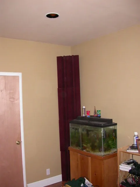

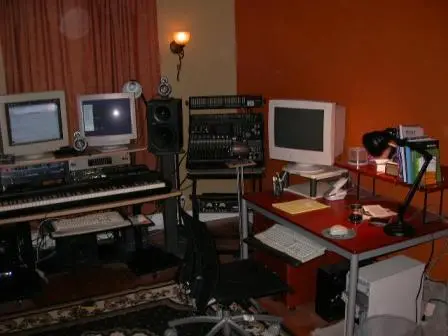

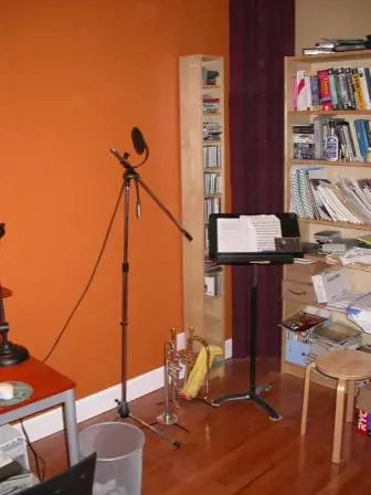

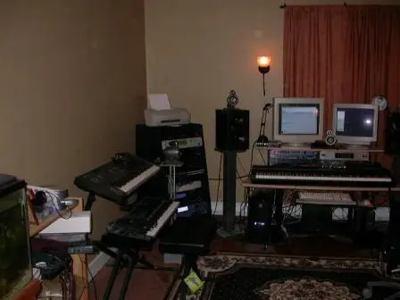

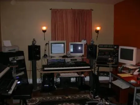

I have built this room. It is 16' by 12'. On one short wall is a 4'x5' window. On the other is a door. I have set the studio up so that the monitors are on the short wall with the window.
I have auralex bass traps in the opposite corners.
I have 2 boxes of auralex foam and want to get recommentations foir putting it up. So far, the advice I have received is to put is up on the windowed wall and the two adjacent long walls such that it is about ear height. Does this sound right?

Hate to see you hangin here with no advice but it is hard to know where to start and the bad news is that spending all that money on the Auralex stuff was most likely not the best expenditure you could have made.
As to what to do with the boxes of Auralex. I presume that returning them is out of the question. You mention placing them at 'ear height'. Sound is bouncing all around the room in three dimensions, not just in a horizontal dimension (requiring that you only treat the walls at 'ear height'). Auralex will mostly help with slap echoes so place some on each side of each pair of walls, however they will look best.
