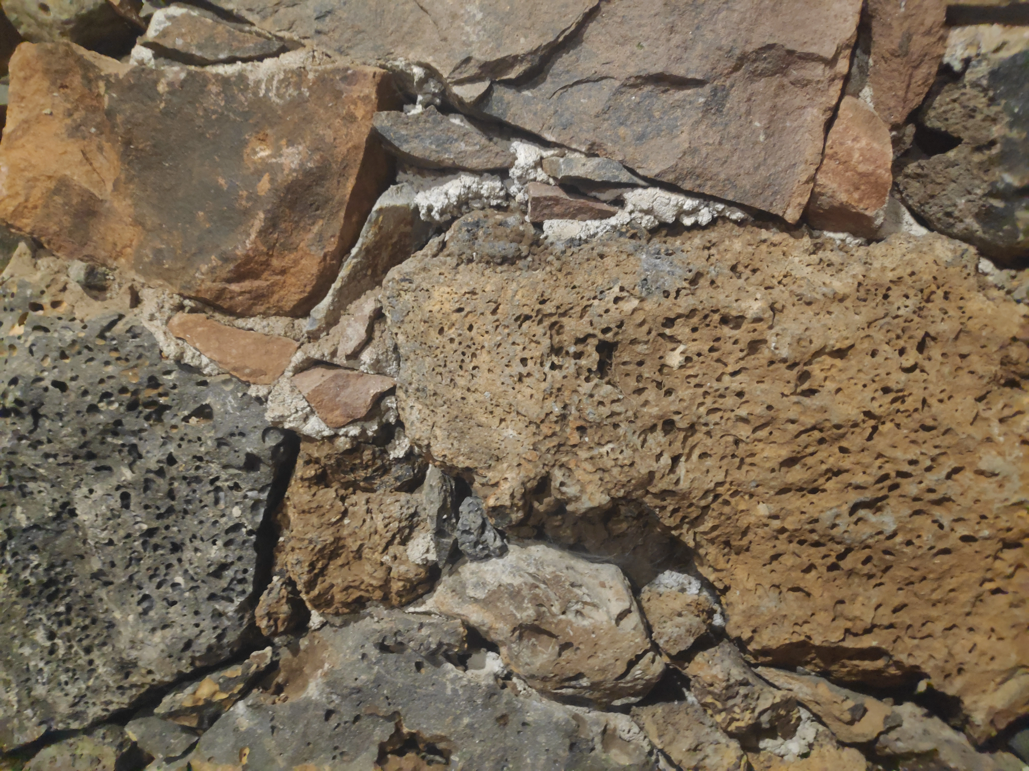

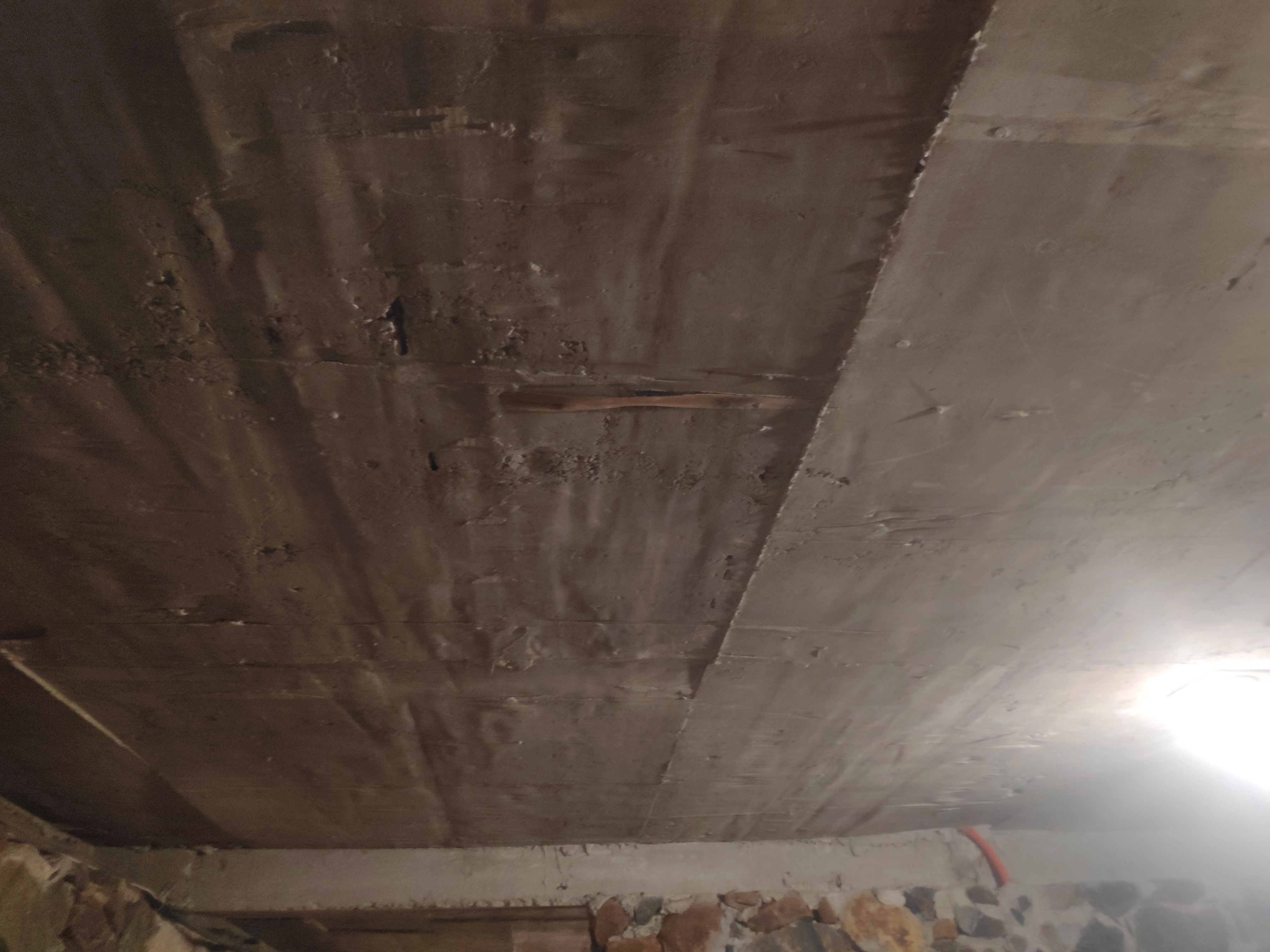

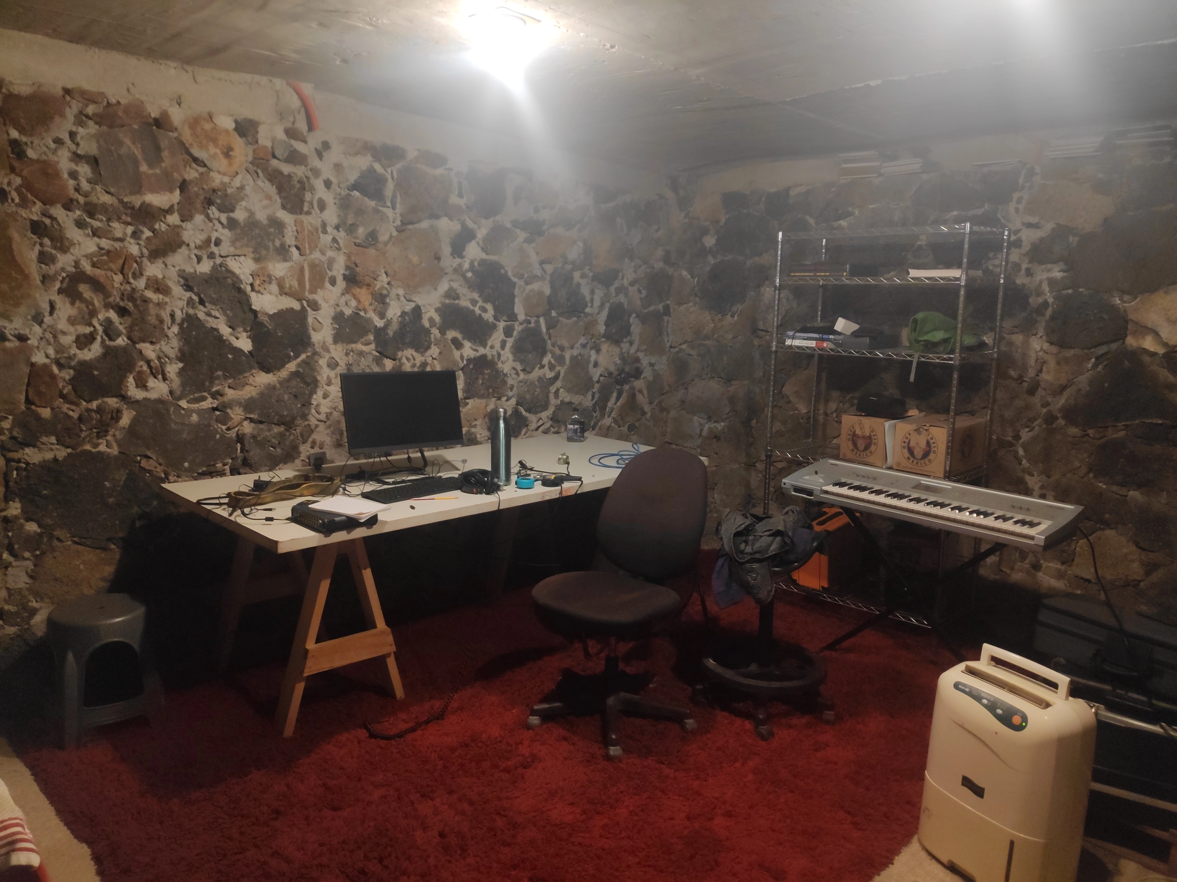

Hello there. I know this is probably a pretty unusual thread. I couldn't find much information on this topic. I'm starting to build a recording space in my sister's basement and I plan to treat acoustics and to have a semi-professional set-up. I'm pretty set on getting a pair of LP8's (I'm open if you have other recommendations) and I got a new computer on the way, but my main question is:
The walls are made entirely of volcanic rock and cement, and the dimensions of the room are 4.7M X 3.7M X 2.3M(H). I'm pretty new to acoustic treatment. I got a big, thick rug on the floor (I also have spare blankets that I figure I could hang) and I'm planning on making bass traps and acoustic panels (would also love some advice on your favourite materials for this). However, I'm wondering if these walls have to be treated differently? Or if perhaps they reduce reflections already to some degree due to the inconsistency of the texture? Any advice would be appreciated!

Is it a stone built building with outside walls or underground? In other words what is on other side of those walls?

Stone and cement will reflect soundwaves. That's not a big space, so start with the corner traps (rockwool or compressed fiberglass, not foam), trhen go form there. There shoudl be acoustic treatment at point-of-first-reflection on either side wall, plus a ceiling 'cloud' above the mix position.

It's underground and the walls are rock and cement all around. The ceiling and floor are cement. Sound isolation is not bad already.

Thanks for your response. I was considering building two bass traps for the opposite corners, with rock wool like you suggested, do you think 30cm × 30cm is large enough? (From floor to ceiling). And then I had in mind making 4 inch thick sound panels (made out of rock wool or equivalent) for the walls and for the ceiling. I had in mind putting up 10 along the walls and 4 or 5 on the ceiling, but is that overkill?
Edit: sorry for the triple post btw. I'm beginning to think that it would be more reasonable to have 7 sound panels along the walls and perhaps more like 3 clouds (+2 bass traps of course). Hope you guys can give me some feedback on that
That isn't going to be overkill. The smaller the space, the more sound panels and bass trapping you need. That space is going to be really reflective, it will take a bit to tame it.

Then if that is the case you may first need to stop any damp penetration through the walls. This will mean a polythene damp course liner applied to the walls first, then you will need to build a 4x2 interior frame completely around the room next to the damp liner.
So you are basically building a room within a room but with a waterproof plastic liner in between.
If you do not do this, any damp passing through these walls and/or condensation because the walls will be cold, will be soaked up by the insulation, which will be then just a soggy mess, become ineffective, collapse and very quickly rot any timber you have there.
So your interior timber wall and insulation has to be isolated from those stone walls and the stone walls have to be sealed behind that plastic membrane.
Estimate to lose 150mm/6" on each wall. So your room dimensions may be 4.4m x 3.4.
If you do not plan to go down the road of making a full studio down there and just want a room with sound treatment to lessen the reflections. I would seriously think about investing in a very good dehumidifier, because the moisture is going to really build up and this wont do your equipment any good.

Thank you for your insight and recommendation Orson, I think that's going to be a major factor sooner or later. The rain here gets absolutely insane so I'm definitely fearful of humidity. I'm lucky the the dry season has arrived and we won't expect rain whatsoever for several months. I'm not sure if my budget allows for building the walls within the room right now, but perhaps I can start like this, I'll get an estimate on the cost of materials to build walls all around, and push through like this until the rainy season is on the horizon again, and then contemplate building protective walls. I have borrowed a humidifier that has been running nonstop for 3 weeks, and it's wild how quickly it fills up.
