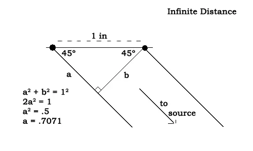

I wish I could draw pictures freehand directly on the web. It would make the discussion far more intelligible. Okay, here's the infinite distance case. Treat the ribbons as a single point in space marked by the black dots. The important value is "a". If the sound travels from an infinitely distant point, it arrives at the rightmost ribbon at the same time as it arrives at every point along line b, so the distance from line b to the leftmost dot (the length of line a) is the time delay for the left ribbon.
We know a = b because it is a right triangle and the opposite angles are the same. I could also have calculated this as sin(45 degrees) = a / hypotenuse, and since the hypotenuse is 1, a = sin(45 degrees).
  • sine of an angle = length of opposite side / length of hypotenuse; for the left 45 degree angle, the opposite is b, hypotenuse is 1.
  • cosine of the angle is length of adjacent side over the hypotenuse; for the left 45 degree angle, the adjacent is a, hypotenuse is 1.
  • tangent is opposite over adjacent; for the left 45 degree angle, the opposite is b, adjacent is a.
The arc versions go in the opposite direction, so if you know the opposite and adjacent, you can divide the opposite over the adjacent and take the arctangent of that fraction and you'll get the angle.

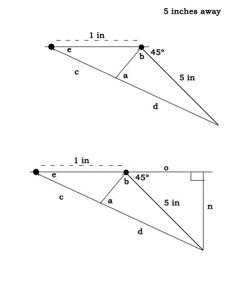

Actually, I think my math may have been slightly off. I'm recomputing everything. based on 5 inches instead of trying to go from 45 and 30 degree angles and calculate the distance, so none of these numbers will match what I did before, and that is intentional. However, I think I might have used a right triangle on one of my two calculations earlier where I should have used an isosceles triangle.... My bad. I think the numbers are probably within about 10% of the right values, but I'm not going to bother to recompute the original numbers. We'll just call them "close enough". :D
We know that a and b are equal in the first part. We need to calculate the length c. To begin, we need to figure out... a lot of things. Start by figuring out the total length of the line containing segment c. To do this, look at the second image.
sin(45 degrees) = n / 5
n = 5 * sin(45 degrees) = 3.53553391 inches
Again, because this is a right triangle and the angles are 45 and 45, we know that o = n.
Thus, pythagorean theorem time.
(3.5355 ^2) + ((1 + 3.5355) ^2) = ((c + d) ^2)
c + d = 5.75 inches, give or take.
Since a = b, d = 5 inches. Thus, c = .75 inches.
And if anybody cares about angle e, we can calculate that with the larger right triangle as well. The tangent of angle e is (n / (o+1)), which would mean e is arctan(3.5355 / 4.5355), or about 37.93 degrees.
