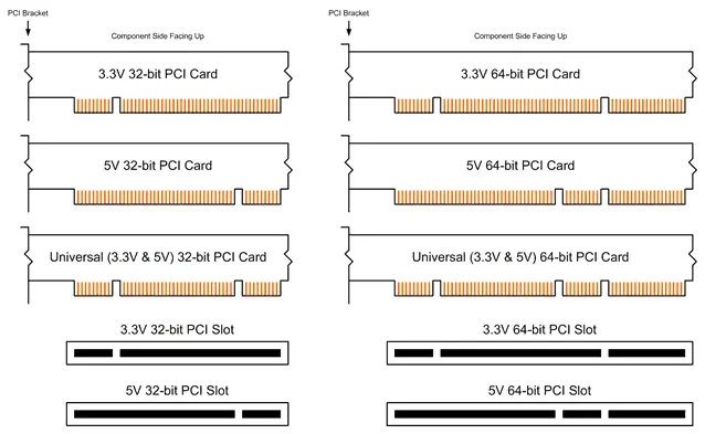

I'm not 100% certain that the card requires 5V signaling. If you want to know for sure, post a high resolution photograph of the card on a website somewhere and post a URL in this thread. The two things we need to see clearly are:
1. The number of physical notches in the card edge connector.
2. The part number on the chip with dozens of bus lines running to the card edge connector.
With that, we can make a pretty good diagnosis of how useful this card will be with current computers.
As Hard2Hear said, if the card requires 5V signaling, that card just plain won't work with modern motherboards. That said, the leaded gas analogy is backwards. The card is like a car that requires leaded gas or it knocks. Modern motherboards are like modern gas stations. You can't buy leaded gas any more easily than you can buy recent motherboards that still have 5V PCI slots.

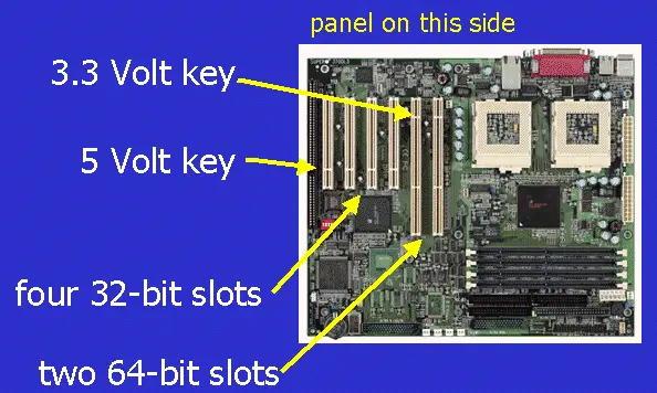

Old thread, but as of 2023 I still have & use my Aardvark Q10's running under Win XP, with quad core CPU's & 4 installed GB ram.
I use ASUS P5KC & P5KC-E motherboards, which I believe those motherboards were released in 2008? They must be 5 volt PCI slots since my Q10's work fine.
But I was under the impression that all PCI slots that are keyed the same as the Aarvarks PCI cards, with the motherboards PCI slot having the shorter part of the slot going inwards on the board, and the longer part of the slot towards the rear were/are 5 volt PCI slots.
There was a diagram I saw that seemed to indicate that the above is the case for the differences of 5 volt vs 3.5 volt PCI slots.
Note; According to a professional PC DAW builder that was/still is? a member on what used to be Gearsluts, he had said that the Aardvarks do indeed need 5 volt PCI slots, I'd be interested to know if that could be proved wrong.
However, the other potential issue is does that particular motherboard support Win XP 32 bit?
5 Volt & 3.5 volt PCI slots, also showing 32 bit & 64 bit variety
