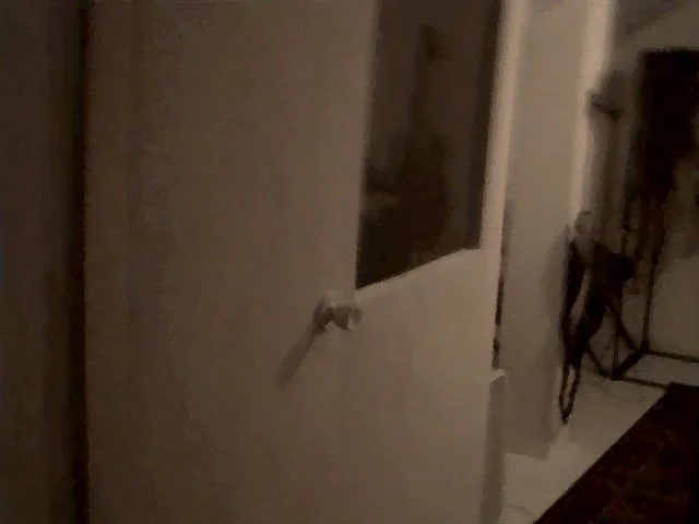

View through window reveals this area will be for seated applications like acoustic guitar, percussion maybe, two back up singers in a pinch ect.

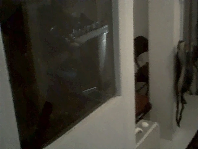

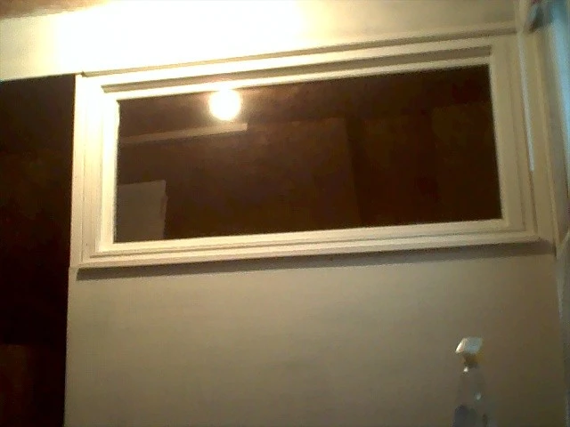

Outside of the same booth we see a bit of the control room back wall.
The window affords a view of my board and tape machine’s Vu’s.

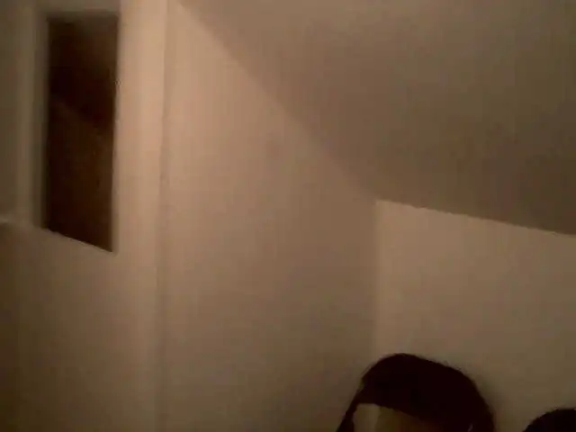

Here is the shape (outside) of the same booth.
Just half inch drywall on 2x4 awaiting an additional 5/8’s outer layer of drywall, a box of nice wood flooring and some excellent interior treatment advice.

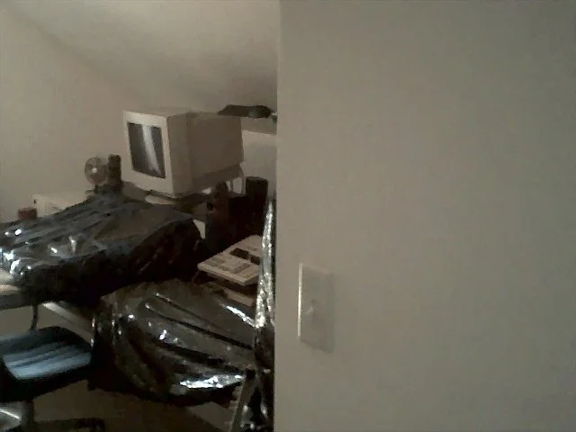

Here you are maybe in the center of the soon to be someday I hope control room.
As can be seen by the underwhelming amount of gear, it’s more room than control.
The “rack” is actually a modified TV stand and by modified I mean turned on it’s side and painted. It’s crude but effective as I can now effortlessly roll 30 million pounds of recorder out for cable access or to sweep even.

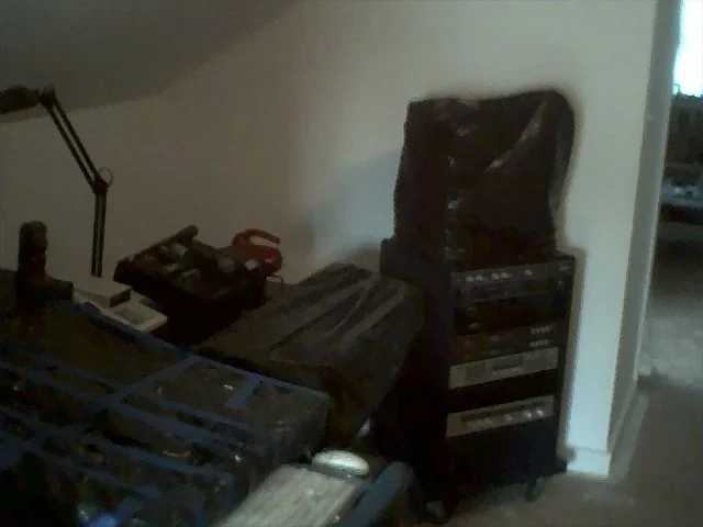

This looks like the poster for flat panel monitor awareness week.
Lots of wall surface to treat here. The natural light lends the room an inviting calm feel during the summer months.
Notice the Roland MC-500?
I believe it relies on the same technology as the model T Ford.

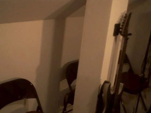

Here you see the back wall of the control room crying for bass traps.
How shall I best treat the boxed in pipe front ,sides and back?
A few foam squares?

Wow... Looks really good, me and my basement "studio" envy you like it's nobody's business
This looks great! I wish I had more space, but....

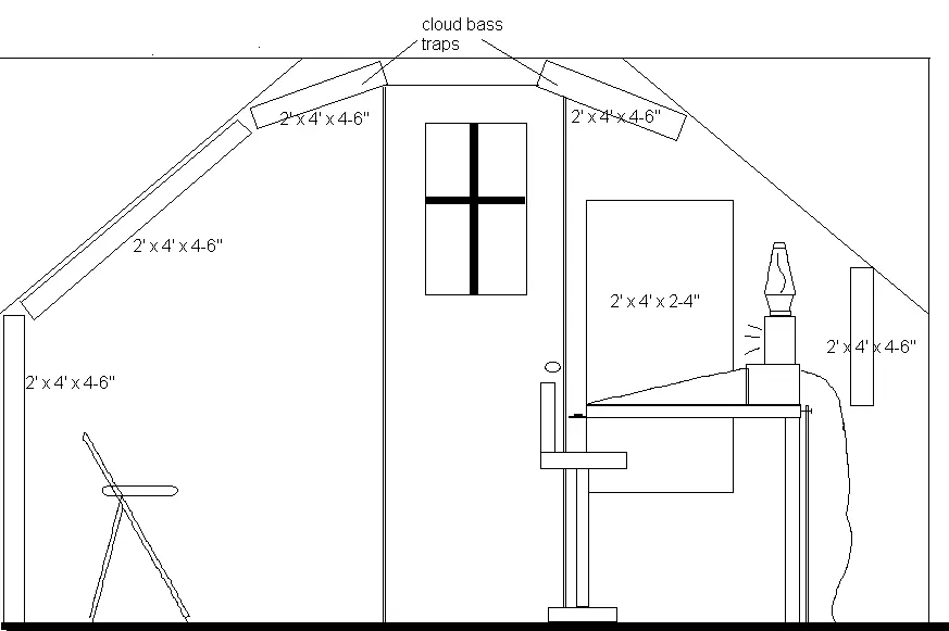

i think you space you have is excellent. I don't think you need that much absorbtion in your control room. I've drawn what I'd do with that room. Check it out

Very cool Panda,
I appreciate your time and thoughts on this as inexperience and a tendency to overdo things on my part always seems to bring about debacle.
-Thank you- :)
