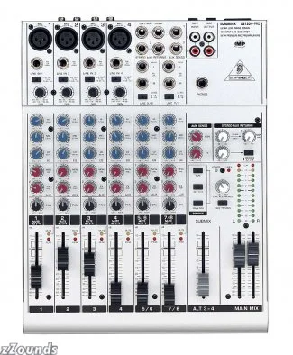

I have a board i am thinking about..
Mindset
I got your pm, thanks for showing me what looks and sounds the set-up i want to have!! Reason i want a mixer and think i need a mixer is because i want to eventually get into the more i guess pro aspect of recording.
Now i have a questions for you gurus that i still dont understand..
I am thinking of getting a Behringer UB1204. this says it has 12-input 2/2-bus mic/line mixer with premium IMP mic preamplifiers.
what does the 2/2bus mic/line mean? I know for sure i am only going to be running one mic. I see that in the front it has 4 faders. does that mean i can have 4 tracks. What is the 12 input?
thanks guys
If you are opnly running one mic, don't go the mixer route trying for what will happen down the road, get a dedicated preamp (for a bargian the M Audio DMP3 will give you 2 channels of decent sound-for-the money, the SP VTB1 is another option for one channel).
That mixer will do what you need, but it is bottom of the barrel for quality. The best thing you can do now, while your needs are small (one mic recording at a time) is to get started and get some experience, same some $$ and continue to read up on the gear you will want. Investing now in a super cheap one thing does everyhting item will just leave you will wanting to upgrade everything very shortly. Get some experience abd buy something you will want to keep for a while down the road. Also- be very vary of manufacturors claims, every company will tell you it has incredibly clear audio that is "professional" quality. They can't all be right. For instance those "IMP" preamps stand for (if i remember) Invisible mic preamp or some such. The implication is that they are such great quality that they are invisible to your signal while boosting the gain perfectly. It is BS, they are about the lowest quality you can buy- however, they do serve a purpose in entry level gear (i just replaced the Behringer mixer I bought back when i got started, so i know- I am still going ot use it, as a submixer for a headphone mix for tracking so it does even still have some use).
As to your question- 12 input means that you can put 12 signals into the mixer, you have 4 mic inputs (the XLR 3 prong jacks) with preamps, and apparetnly 8 other inputs in the form of stereo 1/4 inch jacks (that you would feed with the output of other gear, like a keyboard or diect out from a guitar amp or a CD player or something).
When you are asking how many tracks you have, for a mixer -> DAW you first need to determine how many tracks you can record at once with your computer interface, then you need to see if you can take EACH TRACK from the mixer out DIRECT. See, the mixer is made to mix the signals, combine them together and output them as one stereo signal (capable of being amplified and played through speakers for a live show for instance). if you want each of the channels of the mixer to be its own recorded signal though, you need to be able to have each one split so to speak, so it goes into the total mixed sound, but also can go out direct to you recorder.
A mixer can have several busses, in this case it looks like that mixer has 2, which really basically means you can send the signal to 2 seperate paths thorugh the mixer. So for instance, you can have a one bus that has all the tracks mixed together and a seperate bus with saome of the input left out (you might want to send a bus with only drums and bass to the vocalist for instance, but hear the entire mix in your control room). There are a bunch of different ways to expain this, and I am not the most adept at it, but that is an example of what busses are about.

this is i think pretty much at the end of the day what i am trying to acomplish. I am not making my own beats at this time or messing with anything like that. All i am trying to do is get a instrumental i already have. Have that play and me record some vocals on top of that. I would like for it to be like i have headphone were i hear the instrumental but someone at the control room can hear both me and the instrumental. Then be able to play with the sound/vocal volume to make it sound good or like i say match quality.
When i do that now with my soundblaster which the sales guy told me was the best sound card on the market <-- lol it sounds like crap. not to mention its a $20.00 sony mic. I know the soundblaster is basicklly a toy when it comes to recording. That why im trying to find a way to get my Vocals to sound or be matched with the quality of my intrumentals for mixtapes and hopefully at one point maybe a demo.
