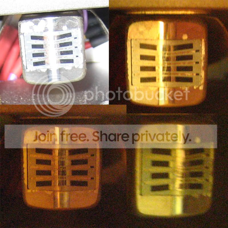

here are some less-than-mint pictures of the head.. I dont think it looks too bad in real life... but could use a cleaning. maybe they are... ayeep.
I lightly swabbed them before taking the picture on the top right. Ill have to pick up some soloution.. pure rubbing alcohol, correct?

Thanks for taking the time to post the images, Noah. While not very clear, there does appear to be some wear to the heads, a flat but even spot. How deep it is, I can only guess but it *may* be responsible for the loss of fidelity, although I cannot say 100% and to what degree. It would help, though, if you could take a close up pict of the tape lifters (in their extended mode). There also appears to be some strange spots near the head or perhaps on them? What is that? Also, pick up some cotton make up remover pads (NOT q-tips) and 90% or higher isopropyl alcohol and, using some gentle pressure, clean several times. After doing so, indeed record straight into the 3440, via its MIC input and post the result, no mixer, no outboard gear, just mic, cable and 3440. Use a high impedance mice cable and an SM57 dynamic or similar. Post the results or see if it's the same poor fidelity or not.
