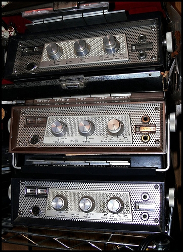

Carnage - the piles of extra junk that can be arranged to shape the sound of a room. Two a77, box of leftovers from a ATR-700 rebuild, three Akai x-IV, two tube Teacs
More topical than a patch of foam

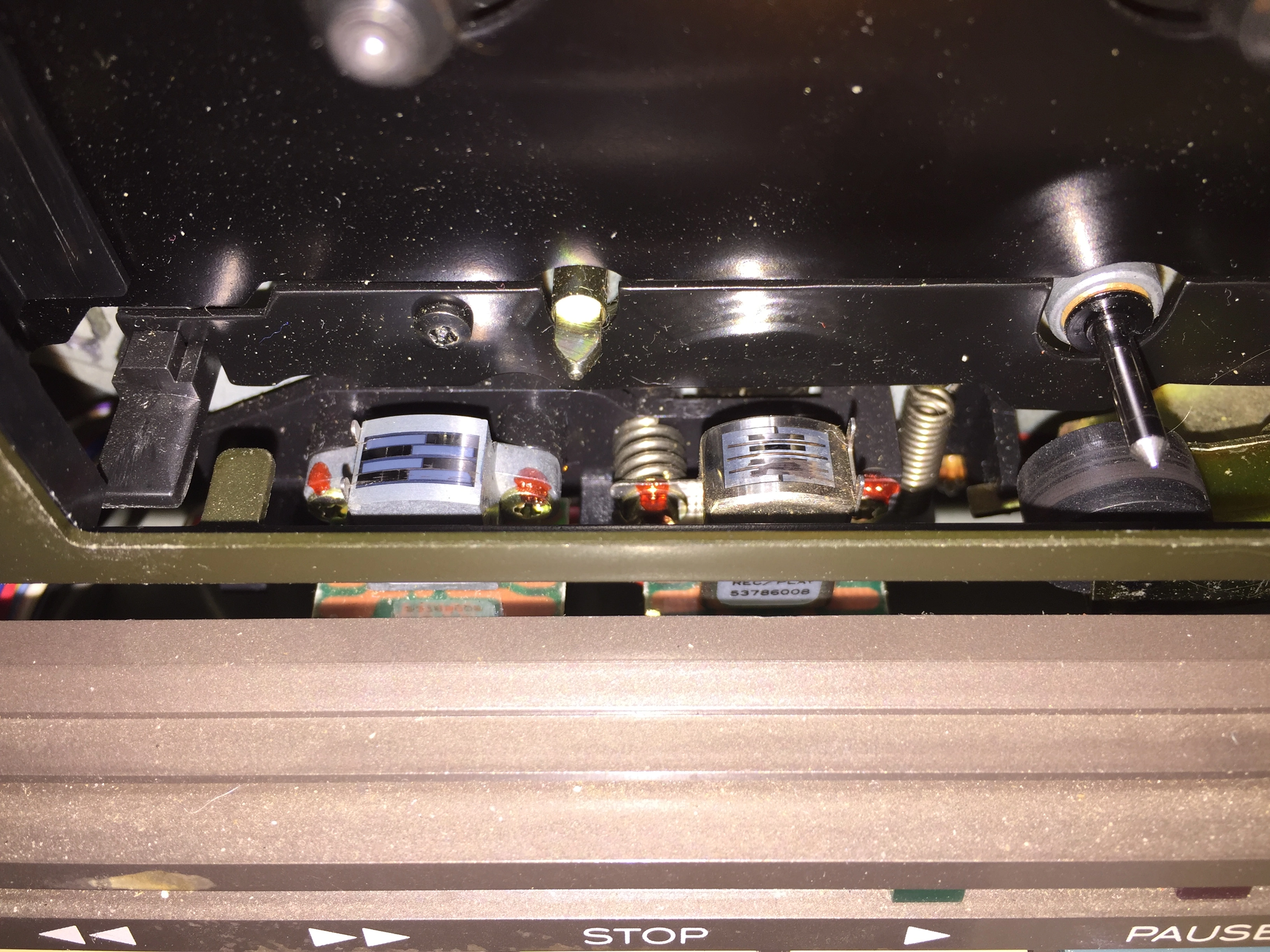

It's fixed!!!!!!
See if you can tell the before and after photo.....
Yeah..... I know..... :) ....except I had just broken open a new box of high bias tapes from National Audio when this happened. First time I've used these tapes.... I'm going to keep my eye on em....
Good idea, but the take-away is the pattern on the heads. Why is it in this area ? It don't hurt to pull out a couple feet of tape and inspect it, though.
I'm doing small parcels of Fuji NOS DR-II, when I can't get decent normal formulations
Congrats on resolving at least one bug-a-boo, Brad. That was going to be my next suggestion (check and clean the heads), but you said it is playing back track 4 fine, so I was starting in on narrowing down an electronic culprit.
