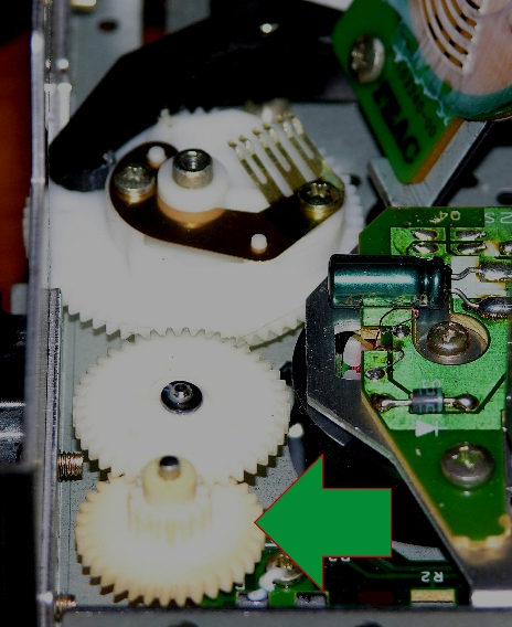

Alright.... so going into this 134 a bit, I found my gear problem. It was "Gear C".
You can see in the picture, the gear teeth have been stripped off. I called Tascam and they said it had been discontinued, and no parts were available. So I think I'm kind of stuck here unless anyone knows another source for "Gear C". My only other thought was if the gear didn't go around 360 degrees, I may be able to reorient it. but I'm betting that gear needs to go all the way around.
Anyone have any ideas?

Thanks for the link SB. I’ve contacted him. Hopefully the 122 gear would work. Do you happen to know the “gear c” part number?
I can get it, but it will be different from the 122 series part even if it’s the same part. Teac often used different part numbers pertaining to each model in which a part was used even if it was the same physical part.
Thanks SB... Skywave is sending one this way. Should be here Wednesday.

I have been using the 9278377600 but regardless of numbers which don't make any difference anymore if they can not supply it, I just call it Gear C and in the picture you show it is very much like the picture I send to clients that contact me to make sure it is the right part. They used this gear in 8 different transports now.
The flashing LED indicate the mechanical processor is confused and can not make the mechanism get to the place it is suppose to go and the cause is the defective gear. I have been selling them all over the World not at the $80 each price I found on E nay but for $30 dictated by the cost to have them made in 2 and 3 at a time by a machinist in TN. He has made me 5 batches so far. I have had to lay out up to $900 for some orders. They may not be $2.00 but they are made with precision and of a much better resin than what was used 30 years ago. I have had NO failures of those sold so far and I have used a bunch myself on my bench. Clean out all old grease and put in Lubriplate 105 and the mechanism will fly to the mode demanded.

Thank you Skywave and Sweetbeats!!! A truly collaborative effort. Skywave the gear worked perfect on the 134. Add it to your list of recorders it works on. Added the Lubriplate 105 like you suggested. Easy to replace too. Although the old gear was pretty brittle.
