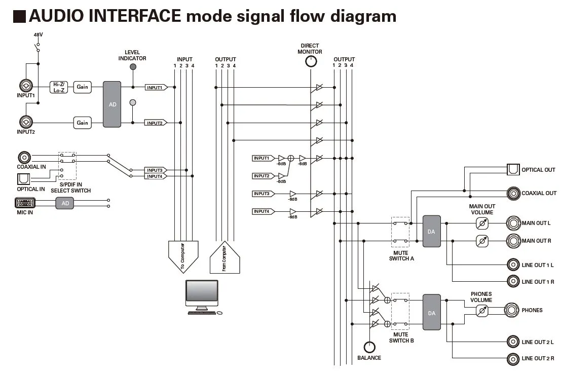

It would appear the U44 would work, either as optical or coaxial SPIDF and you also would have the analog inputs available on the U44 as well.
The 9 pin connector appears to be designed to work with this cable > Focusrite SPDIF-9PIN OctoPre S/PDIF Cable SP/DIF 9-PIN CABLE B&H for a coaxial SPDIF connection. Likely a 9 pin to USB does not exist.

Thanks, all - I appreciate having all your eyes/minds on this: it seems like I have more or less the idea. Focusrite has its own (additional) interfaces that would do the trick - the Scarlett 18i8 for the optical, the Scarlett 6i6 for the 9-pin, but I'm going to give the U44 a shot and see if it does the trick, since I can use it for lots of other things as well.

Anything with more than two inputs such as the 18i8 or 6i6 for voiceover would probably be a bit of overkill. The U44 should do the job and seems like a 'Swiss Army Knife' with the options it has for ins and outs. If you get the chance, make a comparison between using the S/PIDF and just simply using an analog cable connection (may lend an idea of the preamp quality in the U44). Just wondering if the S/PDIF really would make much of a difference. I have an ISA that I run analog and I have no complaints as to the way it sounds.
