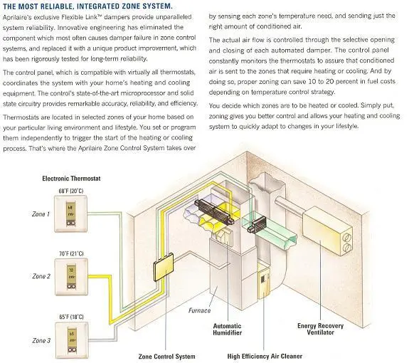

He gave me a brochure that has a nice little rendered 3D drawing of it. I'll scan it and post it here. It's pretty cool! We'll see what it comes in at on monday.

Here's that zone control system. I'll have to see what this comes in at. I have a feeeling it could be cost prohibitive. Still.... It would be nice.

Oh, I'm not looking at the "energy recovery ventilator" (what ever the heck that is) or the "high efficency air cleaner".
But see on the green, yellow and grey supply lines there's dampers that will open or close relative to the room's settings.
Pretty slick!
Yeah, as long as those dampers are close to the air handler and not to the studio rooms - "energy recovery ventilator" sounds and looks like some sort of heat exchanger, that may improve efficiency somewhat.
As to the "high efficiency air cleaner", you might wanna check on that. If it's a HEPA equivalent, could keep your gear noticeably less dusty (speaking of which, has your man mentioned maintaining a slight positive pressure in your rooms so that opened doors let dust OUT instead of sucking it IN? You don't want MUCH differential though - too much and door seals start to "whistle" - gotta be careful there... Steve

The dampers would be right at the unit in the mechanical room, or in the plennum right above it.
It would be nice to have the special air filter, but, you know, you gotta draw the line somewhere.

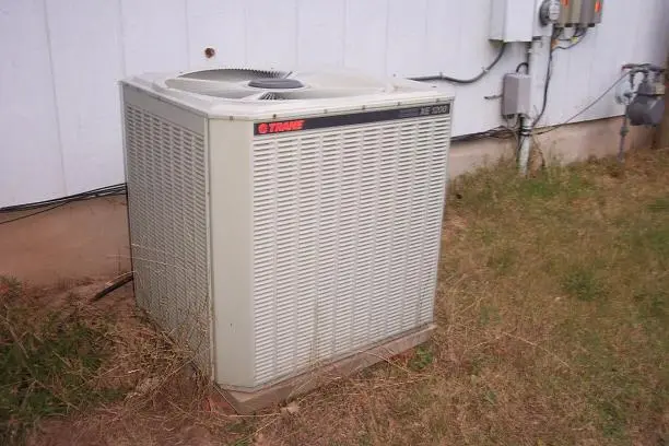

The compressor for the A/C is located outside because they are so big.

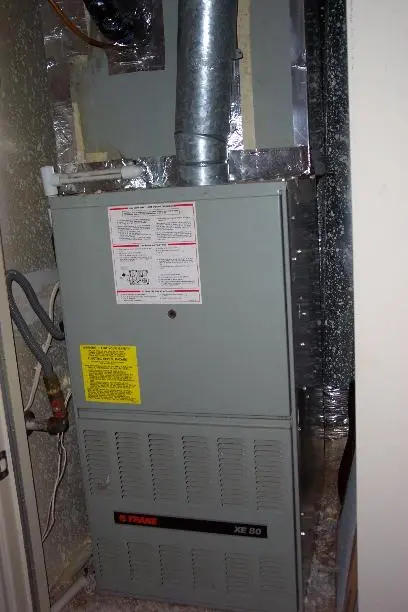

Here's a pic of my home system:
The grey box is the "furnace" but it also houses the blower or fan motor - "squirrel cage" type.
The "box" above the furnace - the one with the silver tape around it is the cooling coils.
Ducting is above that... though not visible in the picture.

Outside is the compressor.
This one for the house is about a 4 foot cube....
Too big to house inside. Plus it needs air to draw through the coils to cool the system down.
Pretty typical system for a residence.
So when you say its "based around a furnace". its not really. Its just that typically, the blower or air handler, furnace, and cooling coils are all integrated into a single housing.
