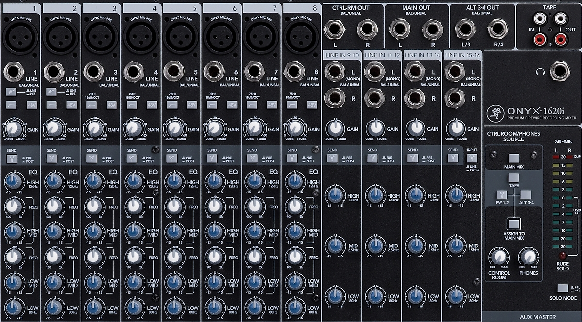

I picked up an 8 track reel to reel recently, Fostex Model 80. Still need to pick up some peripheries for it, including a mixer.
I'm a little confused about how you route through these things. Like for instance, theres a Mackie 1620i local to me for a good price. Would I be able to use the pre-amps in this mixer to record 8 individual tracks to my Fostex? Could I at the same time route back into the mixer to monitor the signal?
Could someone explain some of the functionality a mixer like this has?

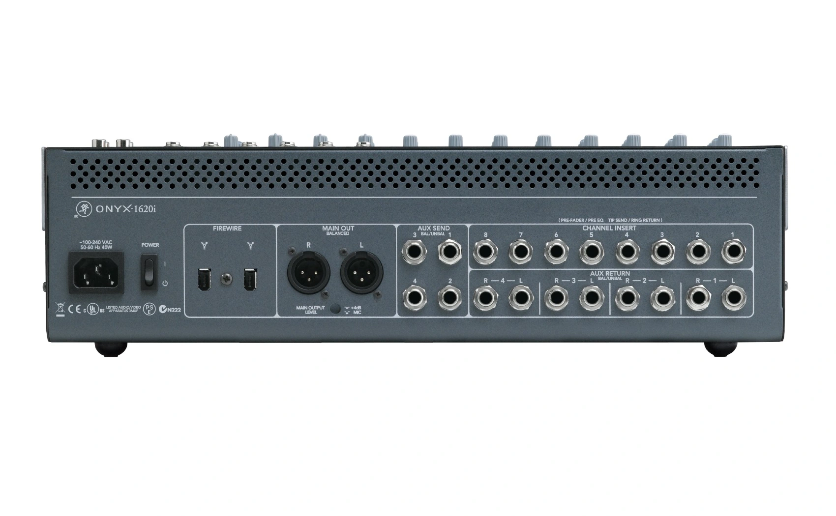

It still seems like I can only send a stereo mix, at best, to the reel to reel with this particular mixer. Other than the firewire to send to my computer, I only see stereo outs. Maybe I'm wrong? I went through the manual, and can't find anything that tells me different.

It's really an 8-channel mixer with some stereo line inputs, not what I'd want for an 8-track recorder. To record 8 tracks at a time you'd have to use the inserts sends, and then there wouldn't be enough inputs to monitor your tracks. I suppose you could use the insert returns, but then you couldn't hear the live input during preroll for a punch. It's just not the right mixer for 8-track recording.

For $300 I'd go for a newer Mackie than the CR1604, like the VLZ Pro. It's got eight direct outs, perfect for an 8-track setup. I think the CR1604 only has 6 mic preamps.
