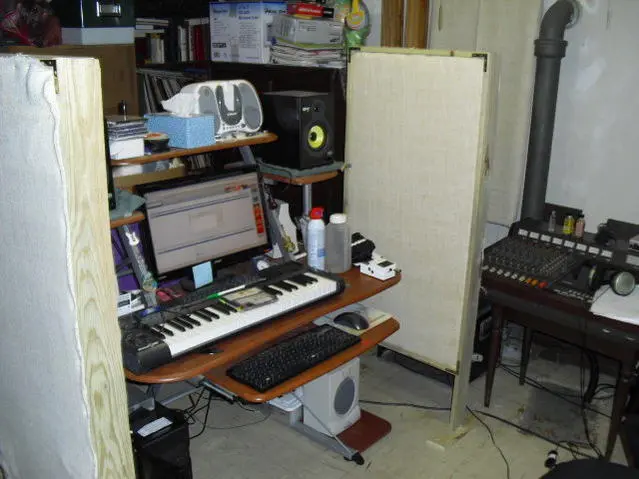

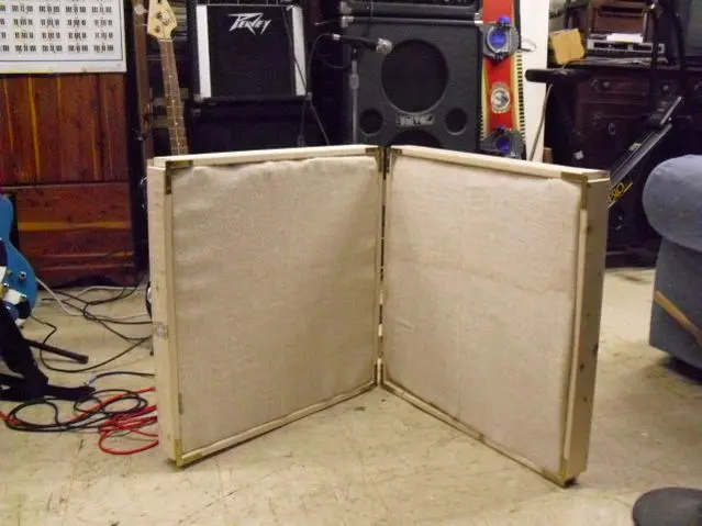

I'd like to inquire for the same thing. Just finished building frames for my 703. Now that I know I have the motivation to actually build these things DIY, it'd be nice to know how much the 4 x 10 x 4" slabs are for future, bigger projects. Thanks!
