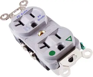

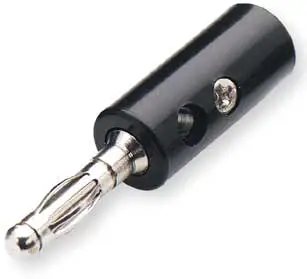

On the PS-520 there is a screw terminal lug for earth ground. You need to attach a length of wire to this lug, & route it down to the "ground" receptacle on the AC power (wall) connector, by using a simple banana plug that fits the "3rd" hole in the socket.:eek::eek::eek:;)
[Ignorance<<] Isn't that detailed in the manual?:eek:;)
COOOOOL!
I don't know if that is in the manual or not...I have read it cover to cover at least once and read and read several sections in detail, but its probably in there.
I bet my local electronics shop has one of those things...
So I'd need to carry the wire back to the wall receptacle, or can I just go up to the PL-8?
Yeah.
I think either is fine. The main emphasis is on differentiating hooking up to the ground receptacle vs. either of the others (hot & neutral). A no-brainer, maybe???:eek:;)

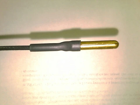

There really wasn't much improvement when I grounded the power supply...I took some 14awg solid core copper wire, found a toast 3-prong extension cord, cut open the remaining molded end, tore out the ground prong and after about 15 minutes of work with a dremel and a soldering iron I had a nice ground wire (see below).
