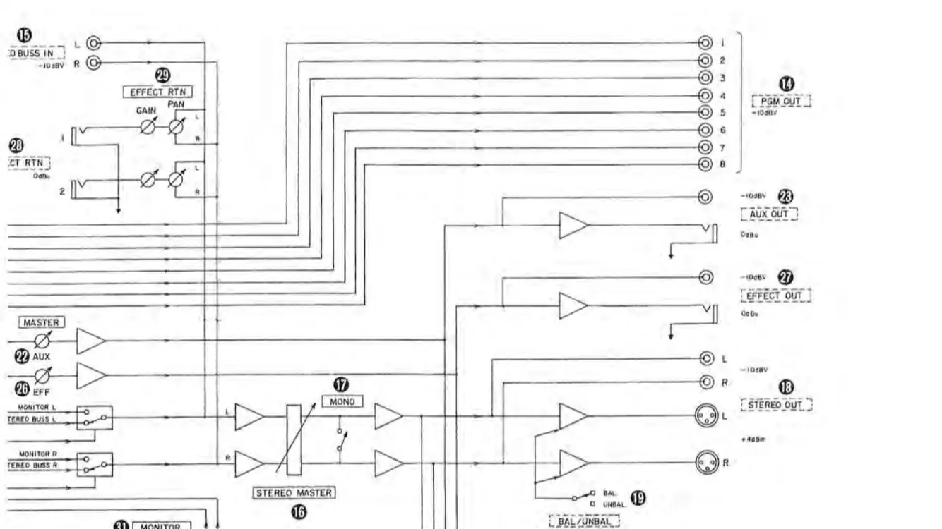

Just use the STEREO BUSS IN jacks on the 388 to input the stereo sun from the M-300 console…that brings a stereo sun into the 388 just ahead of the L-R MASTER fader. On the M-300 stereo sun output, why do you need it to be pre-fade? I’m not asking because I think it’s wrong or anything, I’m just not following why it can’t be post fade.
ahh // thank you about the 388 stereo buss-in is just pre-fader. I assume it joins everything else already riding the buss?
2/ Just one less link in the chain was my rationale. I know there are many ways to skin this, I was just trying to work out a clean simple signal flow.
1. That’s right. Here’s an excerpt from the Block Diagram…#15 in the upper left corner is the BUSS IN jacks. You can see they connect to the input amp for the MASTER fader #16, which of course feeds the STEREO OUT jacks:
