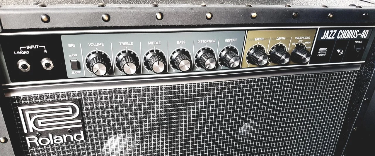

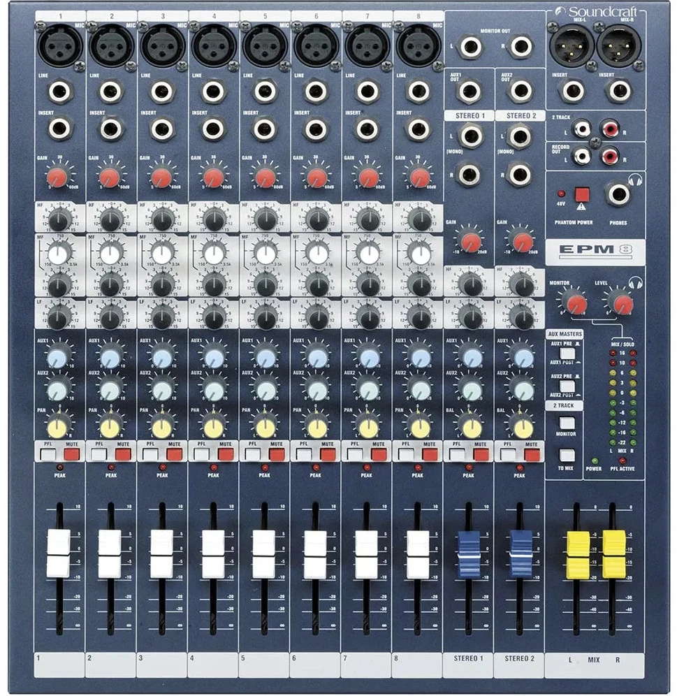

Hello, folks! I'm new to recording, so my question is pretty vague maybe, but I'll try to ask.
The thing is, I want to record different sounds amplifying them with my combo amp for a heavy loud sound. I have a combo amp — Roland JC-40 , a mixer — Soundcraft EPM8, 5 dynamic microphones, and the ZOOM H8 audio recorder. I also have the Steinberg UR44C audio interface and computer, if needed.
So, I want to use 3 microphones to capture sounds, send the captured signals to the mixer and send them to the mic'd combo amp (2 microphones for stereo), to record it with the Zoom H8.
I want to ask if my plan is doable. Is it possible to send signals from 3 microphones simultaneously to the combo amp using a mixer? If yes, how should I connect this chain?
Thanks.

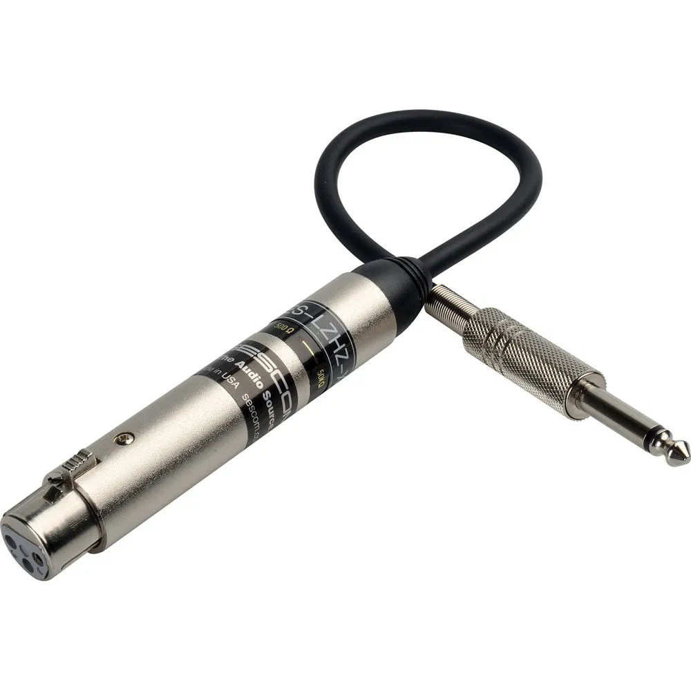

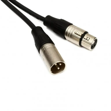

3 mics into the mixer via XLR cables.
Do you want stereo signal to the amp (the amp is stereo)? Or is mono sound ok (left and right combined out of both amp speakers)?
If mono, a 1/4"-1/4" from the mixer's mono output to one of hte guitar inputs on the amp. If stereo, 2 XLR-XLR cables with XLR-1/4" impedance transformer adapters. Then both of those into the 2 guitar jacks.

Hi, Mike! Thank you for your reply.
The amp is stereo with two 10-inch speakers, and I want stereo signal to the amp.
When you say "2 XLR-XLR cables", you mean two XLR/male-XLR/female cables, right? The high impedance adapters should be connected to the cables' MALE ends and then plugged into the amp's inputs. The cables' FEMALE ends should be plugged into the MIX-L/MIX-R in the mixer, correct?
I think I've got it. Thank you again, you helped a lot!
