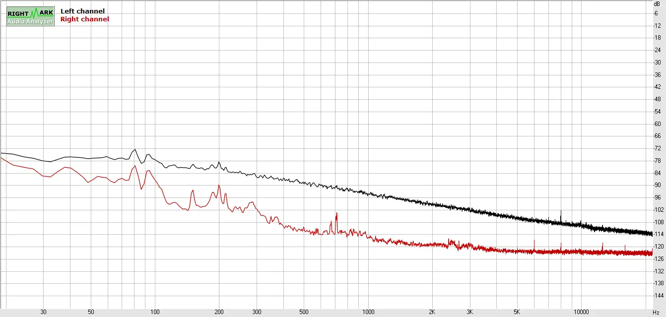

The RMA plot shows the rising noise level typical of a not so stellar selection of FET device but hey! 20 quid! The spikes are from the PC tower the KA6 is plugged into, will try it a m on a laptop in the living room, KA6 again. The lower graph is the remnant noise of the KA, not sure where the spikes at 1, 2, 3 and 9kHz have popped up from, not seen those before.

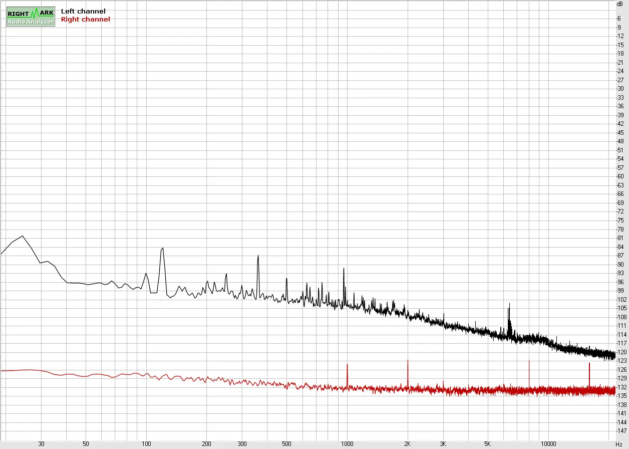

As expected the noise plot is cleaner using a very quiet laptop in my living room early this morning. Right channel is the Sontronics STC 2 (has not been used for months and seems to need to warm up. Noise floor jazzes about)
The mics were laid in a settee and I sat some 1.5mtrs away. I equalled the gains on rms noise in Sam 8 at about -61dBFS . A finger snap gave -14 on the DM and -27 on the STC, a sensitivity difference of 13dB.
Piling jumpers and other clothes on the mics did not reduce the noise floor appreciably but the finger snap was now all but lost. Conclusion therefore that we are seeing the electronic noise floor of both mics. (the noise of the KA6 pres is WAY below any of this)

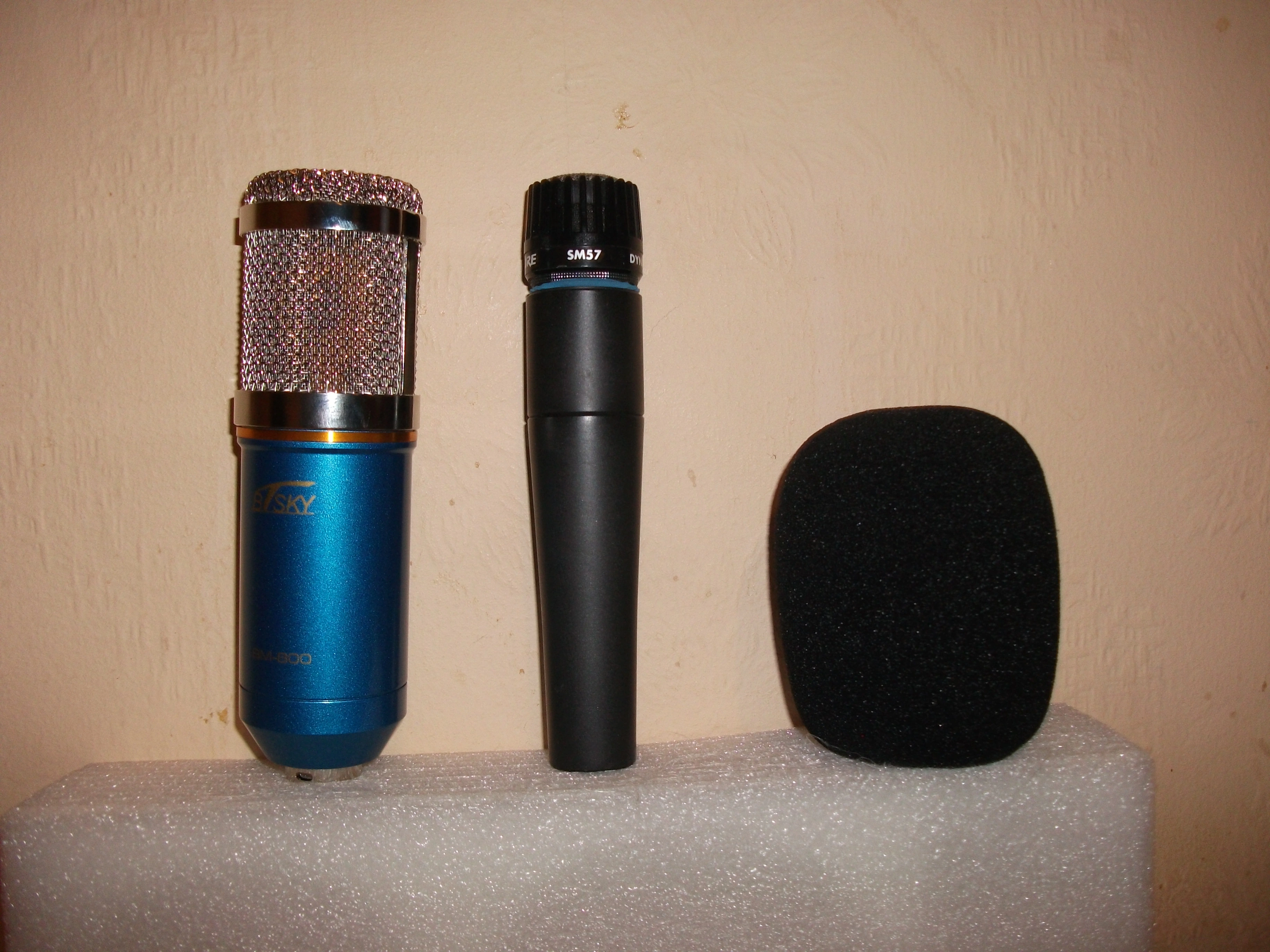

The photo shows the mic to be almost exactly the same length as a 57. It is significantly smaller and lighter than the Sontronics but really is beautifully made, I just don't see how they can do this for a score! The cat's cradle shockmount is not a patch on the STC's and rather stiff, I doubt it will isolate down to very low frequencies but WTF there is always an HPF! They also give you a foam pop/spit shield. FKs why they include that weird XLR cable? Might it work straight into my laptop? Hold the presses!

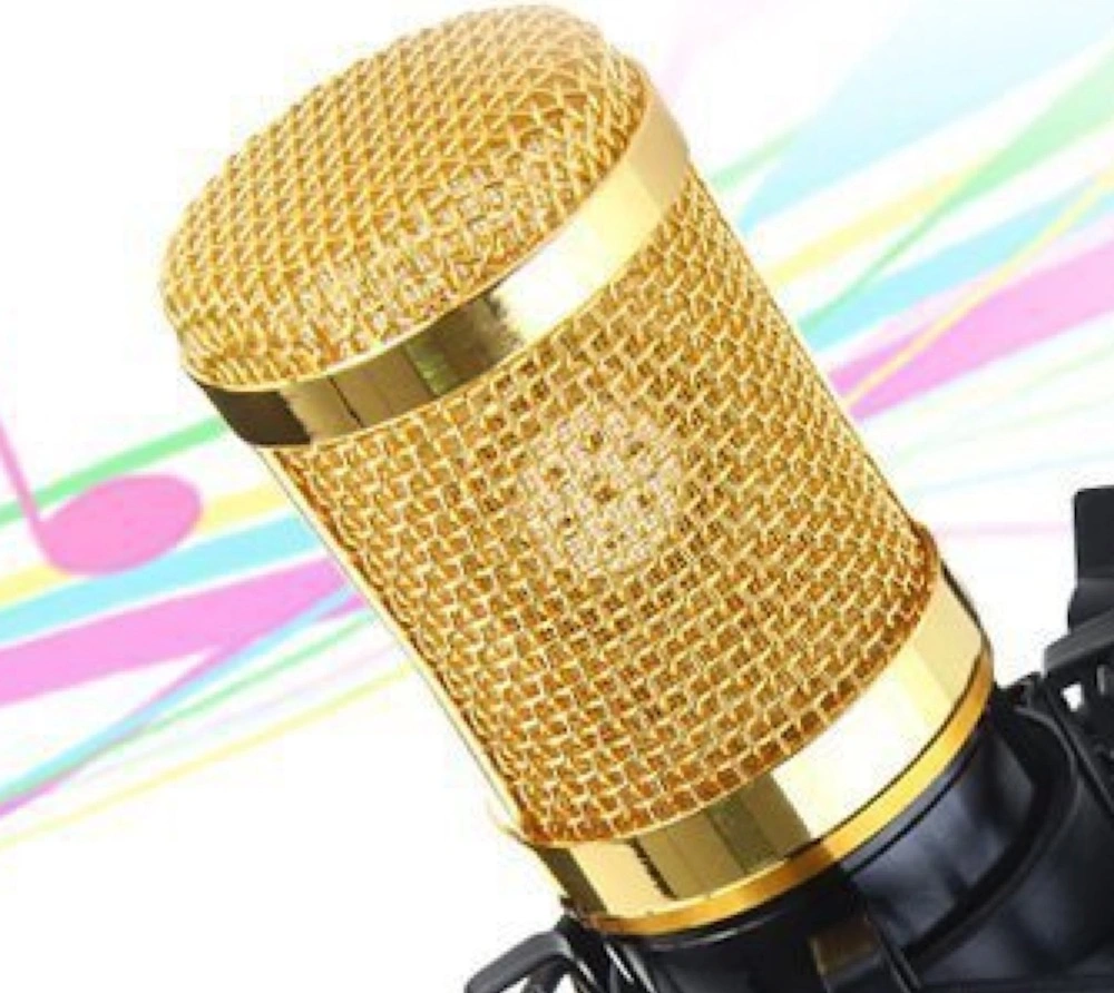

The Sontronics looks like a proper LDC capsule. The cheapo looks like a small capsule in a larger housing.
It looks as if the diaphragm is hidden behind a plate with holes in and could be a cheapo electret capsule, but could also be a dynamic as the pic.is not clear.

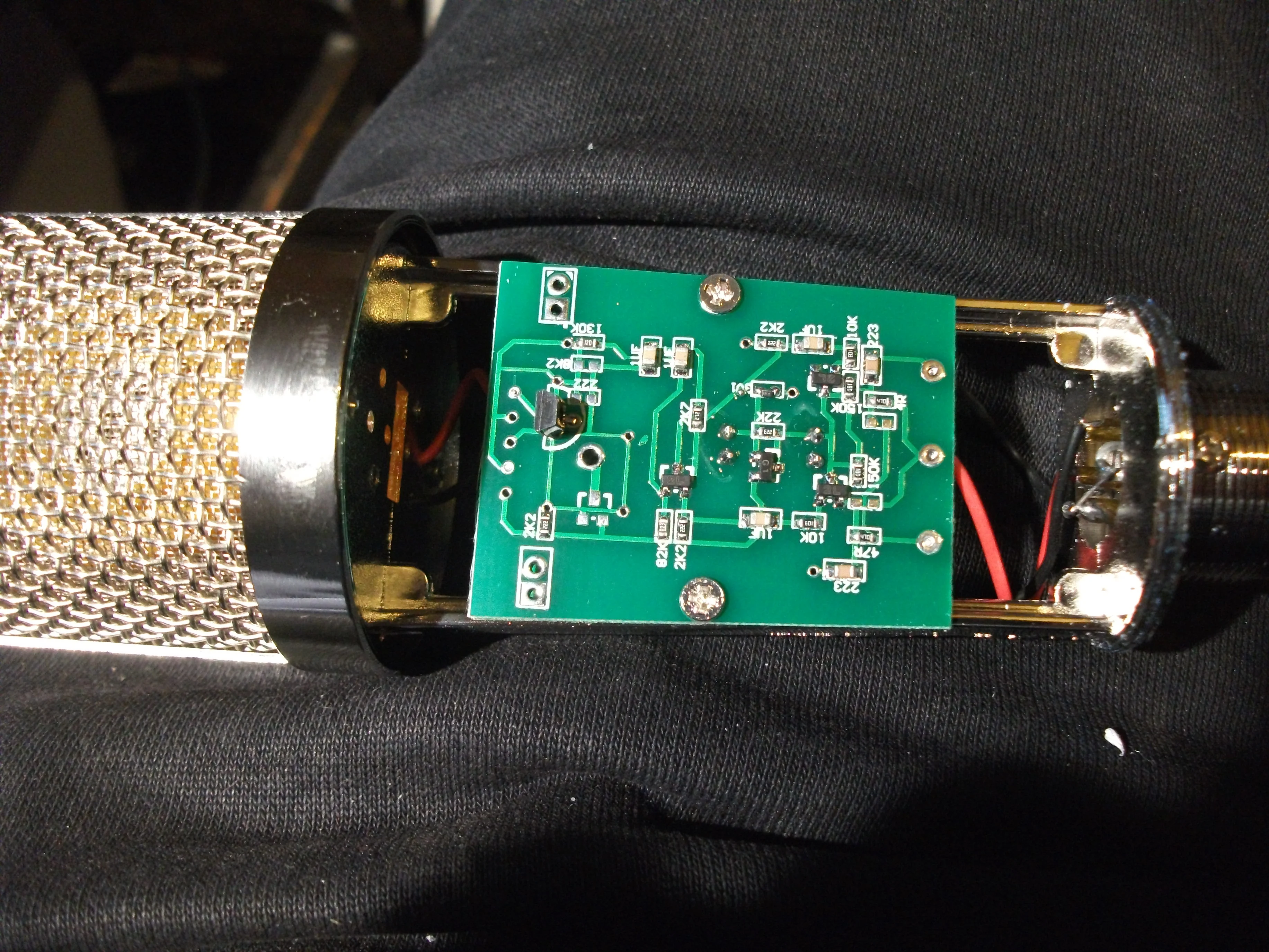

Yes John, it is surely an electret capsule but I expected no less. Pretty much all the USB mics use them.
The capsule is in fact much bigger than the photo suggests but it is hard to see and virtually impossible to photograph!
The give away is the internals. The non-SM device is surely a FET but there are no special gig Ohm resistors around.
The specc' states an output Z of 1500 Ohms but I suspect this is a misprint? I shall cobble something up to test this.
