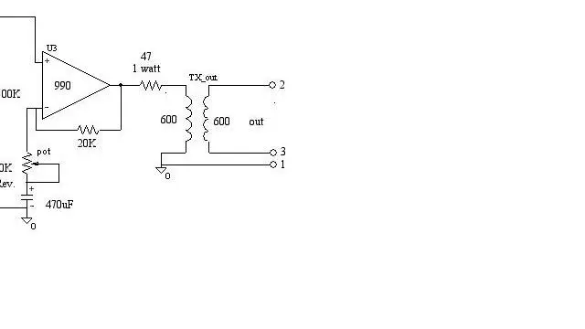

I understand the difference is about 12dB. However, if you use a transformer for the balance output, do you want a 4x voltage gain before the transformer or something different? (assuming a 1:1 transformer)
This is kinda what I'm talking about here (this was taken from another site) the opamp circuit is representative so assuming -10dB into that stage should that have a voltage gain of 4x/12dB or ???:
Yes, or use a 1:4 transformer. If you don't have the power supply (volts) for +4dBu, you use a trafo for the gain, but that means you have to feed it more current for a given load.
