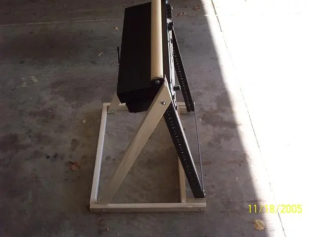

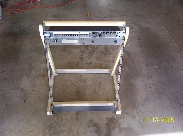

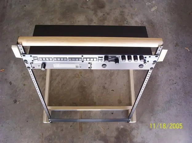

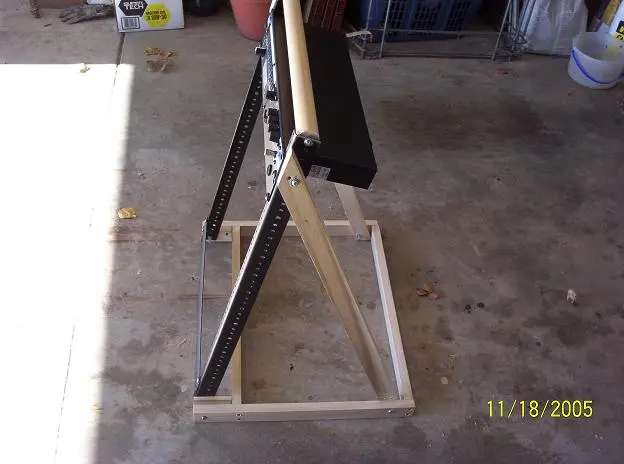

I'm actually doing something similar, although not for my studio. My church is going to in-ear monitoring and I bought the rack-mounted version of the Aviom personal mixers, thinking that I'd put them in 2-space rack bags for each musician (8 total stations). But the powers that be thought the bags looked ugly so I came up with attractive rack stands that will hold the Aviom gear plus the Shure wireless transmitters plus whatever else we want to put in them. The design concept uses 16-space rails (to get the height up to where it is easy to reach) which are attached at the bottom to a wooden base piece made from 1x2 oak. The rails are tilted back slightly and supported by a vertical/angled piece of 1x2. Cross braces on the bottom and a 1.5" dowel across the top (for a carry handle) finish up the assembly. I'll try to snap a photo later on and let you see it. I was very pleased with my idea. I get a 16-space rack that is extremely light weight and is very portable. So far I've only built the prototype, but this weekend I'll be building the real units to hopefully have ready to implement the week after Thanksgiving.

Here are the pictures of my little units. Please note that this is the prototype which I made out of poplar instead of oak for cost purposes. The production units will be oak and will have a finish on them.

Verra nice Daryll... nice job! Clean, and simple, the way things ought to be.
