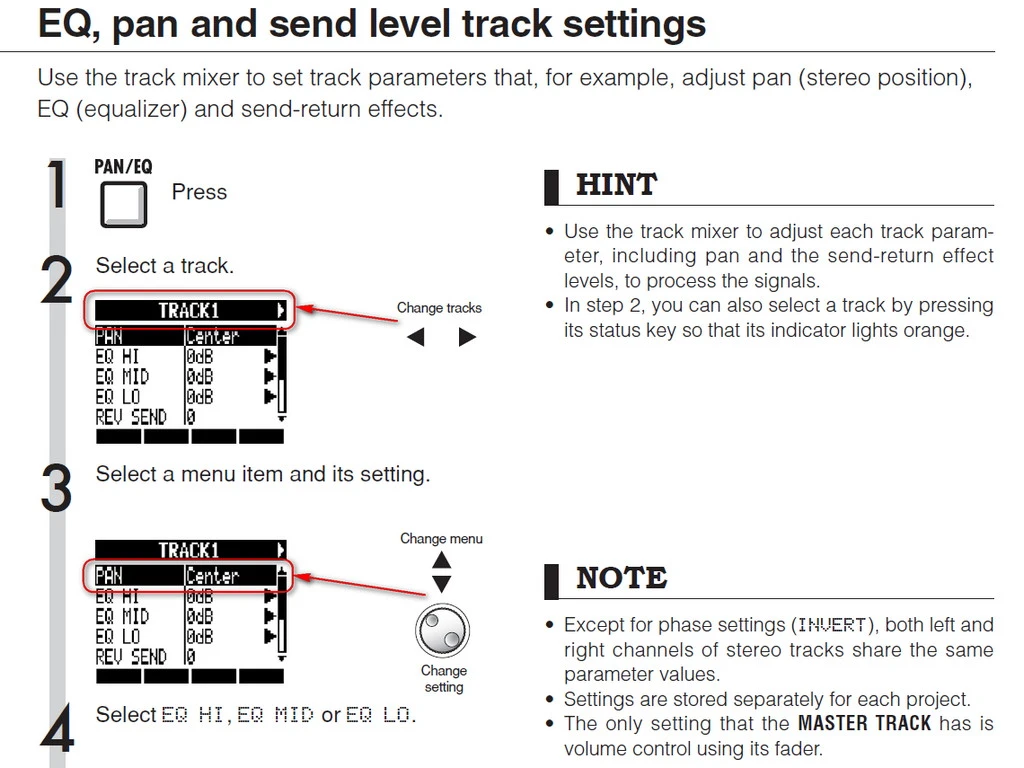

The zoom8 have a headphone jack to test with ? Make sure the few tracks are panned Left and Right.
I have the R24 and your R8 I'm guessing should be similar(?)
Hit the PAN/EQ button to bring up the display below. Adjust the PAN so the mono track is centered or where you want it. Hopefully this does what you want.
