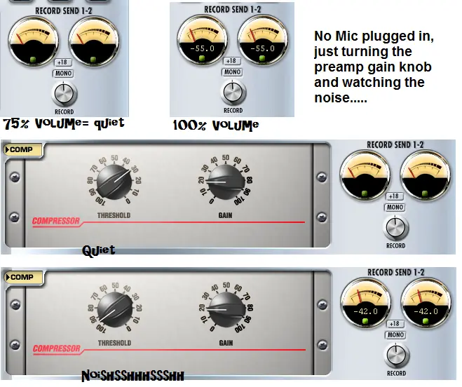

As for getting the gain on your mic before noise comes into play, you can turn down your preamp and use digital gain(preamp plug in or something), or buy a higher powered preamp, 70db apprx, and go into your Line In and skip the preamp.
Here's a test I did on a cheap interface and the preamp noise was fixed.
The gain was boosted using slight changes in plugins and you always have the slider in your DAW at the end.
Notice doing this without anything plugged in can help remove the room and other factors.

I would confirm this is sound advice. I would also suggest, before doing anything, double check your room noise, I downloaded dB meter from the Android store (they have then for Apple)just to check ambient noise. Right now I am running around 55dB, so I set my gate filter to just above that.
Point is, if your room is noisy, putting gain on it will not solve the problem in the end. Just a friendly thought.
