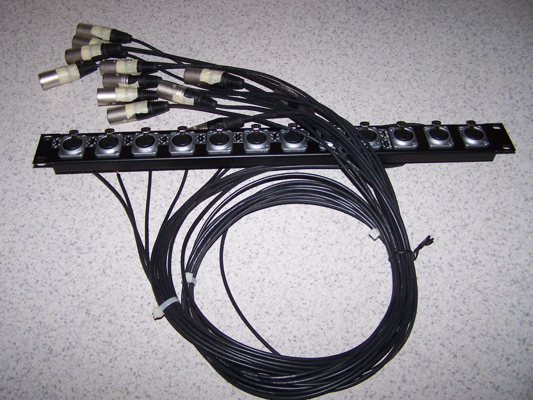

Are you guys suggesting to do something like the attached image? (I've found it online)
I could give soldering a second thought, even if I already have many 10m XLR finished cables I could reuse (plugged into the drums mics), without the need to buy more. I would only have to buy shorter cables to connect from the mics to the patch bay (3/5m).
Yup.....there you go.
You run just the lenght of cable you need to go from the PB to the pres Input..

Do you think I can just "recycle" the XLR cables I have or do I need XLR female connectors?
Can I just unplug the cable from the mics, and "mount" them on a plate?
I would have XLR female connections anyway.
You could recycle the male end, but the female ends would need to be designed for mounting.
