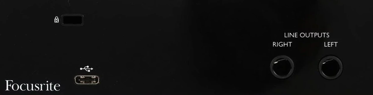

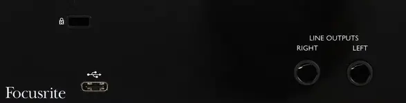

I'm looking at the Scarlett 2i2. All I understand about it is that I'd plug in a XLR cable into the XLR port.
What port is the output? Is it the right and left, or is it the USB?

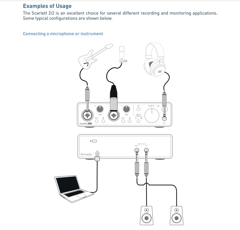

The unit plugs into your computer. Powered speakers and amplifiers go into the output - as in output from your computer. The mic or guitars/keys etc go into the inputs which go TO your computer.
The guitar and Microphone shown here can be reversed - inputs can handle either.
I only have one microphone, so could I just connect my laptop speakers to the left or right port?
Connect the left speaker to the left output and the right speaker to the right output. Laptop speakers aren't really adequate for doing good mixing. Neither are headphones. You will eventually need proper studio monitors (and an acoustically appropriate space) to do good mixes. But if you must use computer speakers that have a 1/8" (3.5mm) stereo connector, it should be possible to use adapters to get it into the two 1/4" (6.35mm) outputs on the interface. Just don't try to plug your speakers into only one.

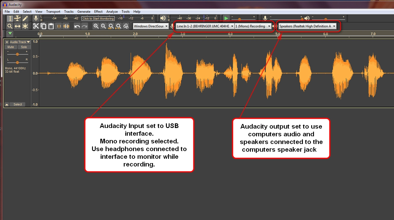

If you want to use the laptop speakers until you can get good monitors that connect properly to an interface, you might be able to use the interface to record into Audacity and use the laptop speakers connected to the laptop as you normally would for playback. This would save the effort of finding adapters to connect the interface to the laptop speakers. The image below shows doing this. I made a mono recording through a USB interface, listened/monitored through headphones plugged into the interface while recording, and played back the recording through my computer connected speakers/monitors (mono went to both left and right).
