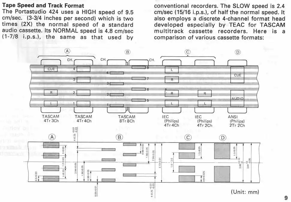

So, I'm wondering if there's an existing high-end cassette four-track which might serve the same purpose. Bear in mind the standard tape speed (1 7/8 ips). I've seen the Tascam 238 recommended, but I understand the four-track version runs at double speed. The Tascam 234L and 134B have also been recommended, but these are super-scarce decks.
So, what say you? And will there be an issue with "track alignment" going between a Fostex and a Tascam? Thanks for any guidance...

I have here manual for tascam 424 portastudio and it actually has high and normal speeds, so you can play "regular" stereo cassttes on it.
I've made a scan of the page from the manual with illustration of tracks layout, see attached.

Thanks for the scan, Dr. ZEE! I note the dual-speed option on the 424. I am also curious about the high-end, rack-mounted units, as I imagine any of the portastudio-sized ones would probably sound similar to the X-28.
