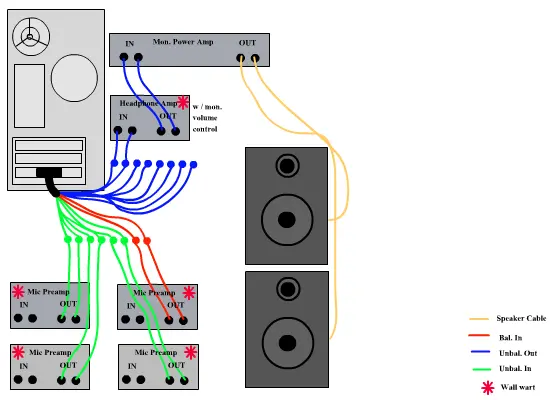

do you think you could draw up a little diagram to illustrate this? i'm not quite getting the whole picture.

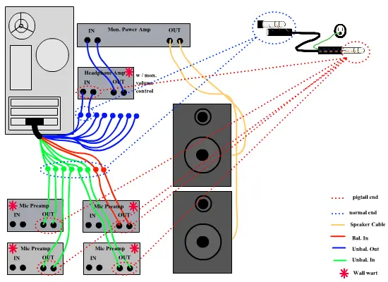

Sure. Easiest soldering job in the world. I'm going to draw this with a U.S. outlet. If you're in another country (outside North America, anyway), the ground may be a different pin. Find out for sure before you do this. :D
thanks dgatwood. i lost this thread until a few minutes ago. i get a intermittent low volume buzz in my monitors some times. do you think grounding my wall wart devices as you mentioned would fix this? this is what my usual setup looks like:
Sorry to sound newbish, but is a wall wart anything that doesnt have a ground prong on its power connector? or is it anything that doesnt connect to power at all?
once you made these pigtail contraptions, where do you put them in the chain? do you plug them into the outputs or inputs of the devices that are wall warts?

what's commonly called a "ac adapter" is a wall wart.........a little black box with two prongs that connects directly to an outlet. from what i can tell, the pigtail end of the cable would connect to the out of a mic preamp and the in of a headphone amp.
wheres dgatwood!? :confused: :D My ins/outs are'nt balanced (except 2 ins). I guess this won't work for me? :confused:
I think this would be the right way to use the pigtails:
You can do this on either an input or an output. Matters not. You usually just need one per device that causes problems, since the grounds on all of the jacks (both input and output) are almost always connected together inside the device.
Balanced vs. unbalanced really doesn't matter as far as this sort of cable is concerned. That said, it is probably better to make the cables balanced. You can always use a balanced cable between unbalanced (or mixed balanced/unbalanced) devices, but you'll get a little quality loss if you use an unbalanced cable between two balanced devices.

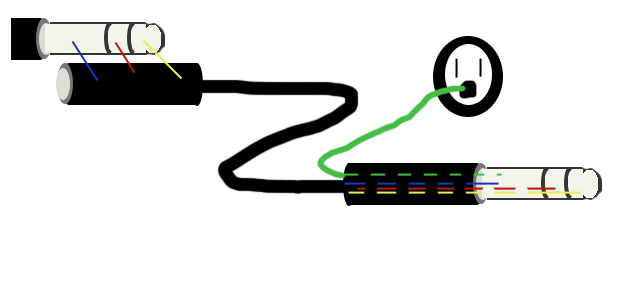

Interesting, so is the point to put a ground on a cable that is attached directly to either the In or Out of a wall wart using device? I am assuming it would be difficult to remove the noise once it has passed through another device down the signal path?

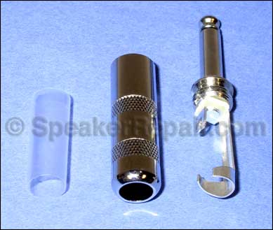

BTW, do you solder the wire to the middle of these three?
something like this:
