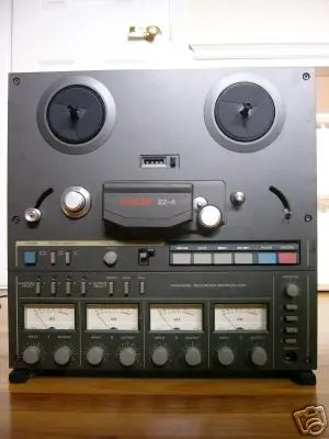

I bid on a Tascam 22-4 and won it. Maybe I paid too much, maybe I didn't. It looks to be in really good shape, the guy has 100% perfect feedback and it will suit my needs perfectly. So, hopefully it plays as good as it looks.
Would you guys recommend a dbx unit for this machine? Also, best place for 1/4" tape on 7" reels? I've attached a picture.
I'm assuming my 246's mixing board will work fine for this device, being a true 4 bus mixer and all. Any suggestions for this machine, things I should look for. Thanks in advance for opinions and help.
A little nervous about getting into reel to reel and the possible overhead I might be facing :o
here's the pic...paid $175.00 plus $45 for shipping.
From the picture you posted of the 22-4, it appears to be missing the right side tension roller which is a fairly important part!
You might still be able to buy the part from TASCAM's parts department. Give them a call.
The other things to be mindful of is that all the rubber parts might need replacement too because of the age of the machine, even if well cared for, (which I have my doubts because of the missing tension roller), can still degrade with age so the capstan belt and pinch roller are things to also ask the parts department about when you call.
The optional dbx noise reduction unit for that deck is called a DX-4D and are readily available on ebay and elsewhere.

In addition to what Ghost said and if my eyes don't deceive me, the left tension roller cap is also missing [on that 22-4].
and now...my nightmare begins :mad:
Should have had you guys look at it before bidding. I still have hope though. Maybe somehow it fell off early in it's life making it a low use unit. It still looks to be in excellent physical shape, and the seller seems to be reputable so his description seems promising. I'll know when I get it. Also,
if I'm using the 246 as a mixer, will it's onboard dbx work function apply to the 22-4? Or will I need an additional unit for that?
I'll call Tascam parts today...thanks cjacek and ghost.
Yup, somehow I knew it was a rather emotional / impulse driven purchase on your part but that's ok, we've all been there. I would have personally steered you in another direction, like finding something locally rather than dealing with much incompetence on eBay, from the actual condition of machines to, gulp, packing / shipping. :eek: Where about are you located?
You will need a seperate dbx unit (dx-4d) for the 22-4. I, however, wouldn't bother with all of these details for now 'cause I'm genuinely worried about your transaction and whether the units' in a good condition and if it will be packed well as to survive the transit. I don't want to bum you out. That's not my intention.
