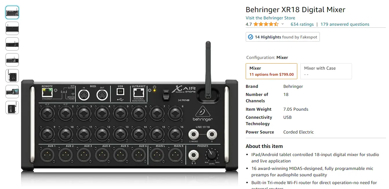

There are a ton of other choices. Just to confuse things and add more choices, for about $300 more you can own a Behringer XR18 and have a whole lot more inputs and outputs and routing options than any of the above.
These have become quite popular over the last few years beyond being used to use as a mixer to record live shows but as an actual a 18 x 18 studio interface.
I own one and rarely use it because I usually am only recording 2 tracks at time so I just run through my 2 x 2 usb mixer. But I have it in my bag for when I do want to use it.... It is a learning curve to use but powerful.
