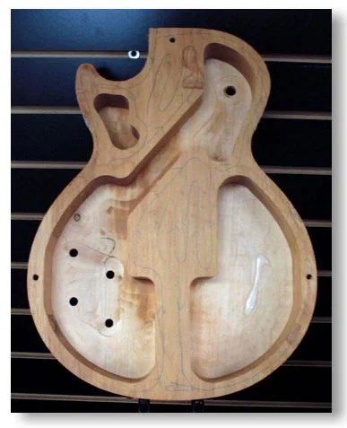

And I would appreciate very much if any of you can show me pictures of the chambered room.

Supremes actually aren't chambered in the way that a Standard is. The Standard has round holes drilled in to the mahogany about 1.5" in diameter or so. The Supremes chambers are huge, almost like a semi hollow, I'll go look for a picture to show the chambers.
here's the picture, along with a link to the thread in a different forum
