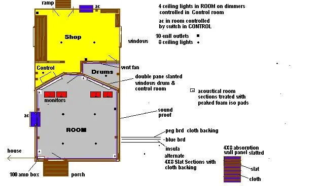

I'm new to the board , this is a great place. I've been doing recordings since 65' 4trk 1/2 inch, now use adat, the reason I came here was for the ada info from the digital gurus (you might be some), just finished building a studio/the shed outback with 4 rooms and like someone else here I'm using the drum booth for a dead vocal spot, have a control room (both with angled glass) and out back my motorcycle shop haha I've been doing some research on the wall treatments, is this slat over fabric really a good sonic absorber with double walls? I've broke up the big room into alot of surface angles. Anyway I'll try to attach a sketch and I've got to say whether it's live or controlled, music is a good life. If anyone has any experience with this acoustic issue let me know.
