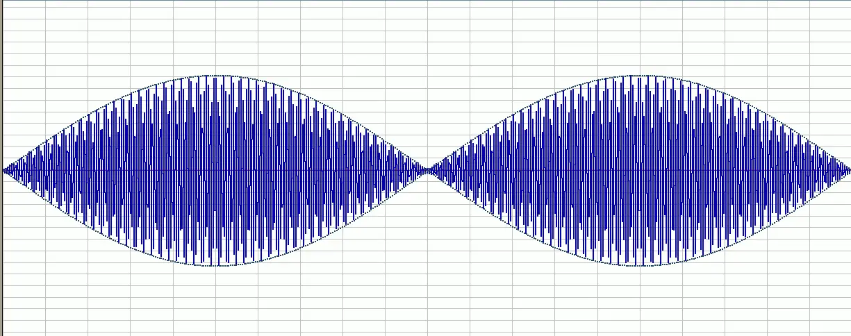

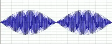

Here is how a 22000hz sine wave, 20ms long, sampled at 44.1khz, looks like. (generated in digital domain)
Yes there definitely is 22khz content, but also an added 50hz amplitude modulation.

You are getting confused between the theory and actual practice. The theory assumes a brick wall low pass filter that doesn't exist. The theory is correct, the implementation is a compromise.
But, even if you could hear 22k, it would not be there. The anti-aliasing filter on the DA would take all that out.
Get an oscilloscope and play this file into it, tell me if you see anything. You are looking at a computer algorithm guessing what the wav would look like on an ocilloscope. It's not real, nothing is real until it hits the analog world.
The theoretical brickwall will be after 22050hz, but the wave is 22000hz, so it won´t be affected by that brickwall. Which means I don´t need to take it into account because it cuts only all frequencies higher and those are not present in sine wave.
You say the 22000hz won´t be there, or the 50hz?
The digital-analog conversion doesn´t play any role, because the theorem says that the original function is determined by the samples, and I have shown that there exist at least two different input waveforms that produce the same samples. Therefore the function cannot be determined by the samples.
