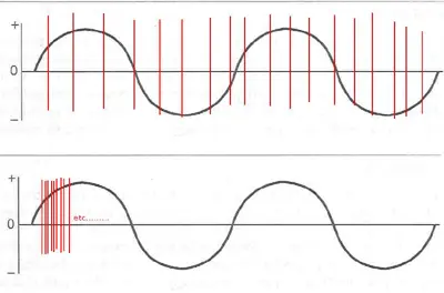

Guess I've been wrong about sample rates this whole time. I thought more samples per second gave a more 'detailed' description of the sound because there is more information over time.
Like this (shitty example) thing I just made in MSPaint...
