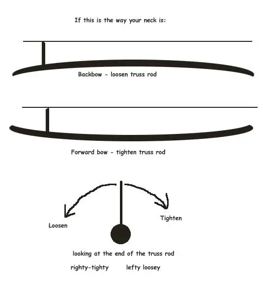

Maybe this will help (or maybe not.)
Yep thats fine. Post that in a new thread, title it "Graphic description of a single action truss rod", close the thread, ask for it to be stickied and remove this thread. If a more in depth description of what actually happens to the truss rod and neck timber when you adjust it and how to approach it I'll add it.
Job done.
